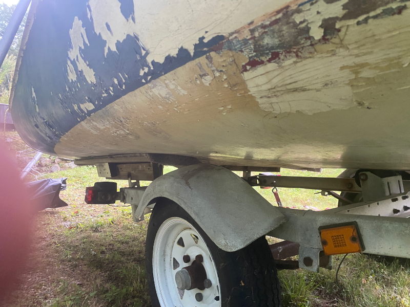

I pressure washed the cockpit, which removed most of the paint. Looks like the PO may have tried to fix some leaking by coating the bottom with 4200? At least is is not 5200. It does budge with some muscle from a scraper.
I have to believe the lack of stringers and/or bonded seats have caused significant flexing that has caused prior leaks. This may explain the goop on the centerboard truck. I also found a lot of silicone which I am sure did very little to stop leaks. The way I see it, the only fix is to completely remove everything to the bare glass and add synthetic coring to provide some structure. Then also add some layers of glass to the centerboard trunk. Not a cheap or easy fix, but still doable. To your point, Green Lake, at least nothing is in my way.
I was actually kind of encouraged I was able to get down to seemingly viable fiberglass (scroll to the bottom of the picture). Still a lot of stripping to do before I can consider coring it, but I really only spent an hour or so with the pressure washer, no sanding or grinding yet. I think I would need to suspend the boat off of the trailer to get the hull in the proper shape for coring.

In this picture it shows the lack of tone in the hull sitting on the pads. We can also see on the right, which has no paint, what looks to be the original gel coat with some longitudinal cracking, probably from flexing. Looks like maybe the boat was originally white with a maroon waterline stripe. Every inch of this boat requires some love.

Cockpit: I'm not surprised you were able to get close to glass quickly. The insides of these were only ever painted, no gelcoat as far as I could tell (or not a very thick layer).
You do want to cut some inspection ports (as large as you can get lids) into any flotation tank. You are likely to find sodden, waterlogged styrofoam. That's what I found in my bow tank.
Good point on suspension to give you a good hull shape.
Waterline: the stripe for the waterline should be a strip of different color gelcoat. If so, you won't lose all of it unless you sand to the fiberglass.

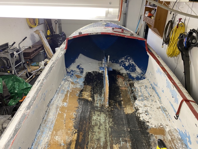

Update on progress:
Moved the boat indoors and suspended the stern on pallets and bags of wood pellets to take the load off of the deformed spots in the hull. I can see the boat had stringers at one time but they were removed. I can only guess why.
The boat leaks from the aft end of the centerboard trunk despite prior efforts to remedy the issue; glob of epoxy on the underside, silicone, Bondo, and worst of all an eighth of an inch of tar over the inner hull. I think the continued flexing from the lack of stringers has been causing unresolvable leaks.
Anyway the solution is to strip back to bare glass and address the lack of rigidity with some new glass and coring. For now heat gun and scraping of paint and tar is the task. I have removed about 3 lbs of tar already. Next is likely Goo Gone and acetone prior to sanding. I will also probably use Citri Strip for the remaining paint.

Inner hull

That looks like a job and a half, good on you for keeping at it! For what it's worth, the early DS hulls do oilcan, it's nearly inevitable. It's worst just a bit forward of the Centerboard, so I'm a but surprised that the CB to hull joint is leaking. Once you get the tar/gunk off, I'd lay in a nice radiused bed of epoxy, put a layer or preferably two of fiberglass bias tape on it, soaking in a few coats of epoxy. Look at any website on stitch-and-glue plywood boat construction for how to do it. If you can finagle it, you may want to put a layer of fiberglass on the outside of the CB-Hull joint as well. It not as if you have smooth laminar flow there, so you won't be slowing your hull down if you put in some glass on the outside of that joint. I'll let GL chime in here....

Postby GreenLake » Mon Nov 06, 2023 7:09 pm
At some point the DS1s got a drain at the back edge of the CB trunk. Once you've removed all the gunk you should be able to confirm whether you are dealing with a hole from such a fitting or a cracked trunk.
If the latter, I would grind the outer hull a bit to allow a layer of heavy tape over the outer edge of the cracked while not adding any more overall thickness. If the existing laminate is cracked through, you should feel free to grind away inside and outside as long as you leave just enough to hold the CB trunk in place and retain a solid substrate onto which to lay up the fresh laminate.
What Tom means with the pointer to "stitch and glue" is that there the wood is the substrate and when laminating corners you need to fillet then to ensure a smooth radius. And the usual technique includes using tape of decreasing widths to avoid hard spots (on the inside). On the outside, if you add laminate you would fill an area you ground off, so the surface would end up level and no worries about hard spots. But you'll need to fair.
On the inside of the bilge I 've gone back to gelcoat. It's more durable than paint wrt moisture or walking on it. As long as you test the amount of catalyst needed, apply it with sufficient thickness and get the kind that cures in air it's not complicated. I have an older post on this somewhere. I used a spreader to apply and liked that the result was a bit structured. That worked well with the surface being already a bit uneven from tabbed CB trunk to stringers.
