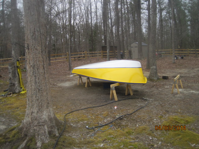

Postby ddodgen » Thu Apr 03, 2014 12:57 pm
been a few weeks while I scape and remove bunch of barnacles, remove old bottom paint, repaint above water line and below and now apply boot stripe. Pretty pleased with the work. Now I want to let it sit for about 3 weeks to cure before I get all of the neighbors to help me turn her over and put back on trailer. Then the work topside begins. I think that from I can see the gelcoat is in great shape just needs cleaning and compound/polish. Will be installing the centerboard this coming week.

Postby K.C. Walker » Thu Apr 03, 2014 3:38 pm
That looks great! I love the color.

Postby ddodgen » Thu Apr 03, 2014 9:16 pm
She came yellow with a nasty black bottom paint and black bootstripe. As I was stripping her I did not see any other color so I guess she came from the factory that a way. Couldn't stand the black bottom so I used an Interlux VC Performance Epoxy bottom since it will be trailered. I have used Interlux before and as usual it was easy to apply and I think it looks just right. Thanks for the compliment.
Can't wait to turn her over and see if my estimate of the topsides is true. Water in June.

Is that Brightsides Yellow? It looks more intense than the Fighting Lady Yellow.
Re: Having Fun
Postby ddodgen » Sat Apr 05, 2014 12:26 pm
Yes, Interlux Brightsides yellow. A little brighter than the original yellow but it grows on you. I have restored an old Chris Craft 35', a 30' Owens and built several small sailboat and rowboats with Brightsides and it never disappoints.
