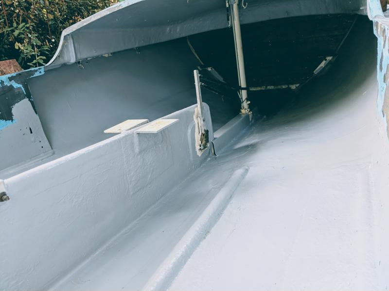

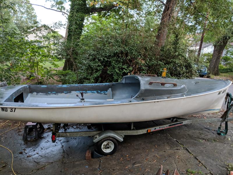

Some progress on #37, then a long delay... I was overseas, a close brush from Hurricane Flo, and LOTS of rain. But, I've got the bilges cleaned out and painted, along with pulling all the rotted seat supports (cleats), tightened all loose hardware, and checked all the foam (nice and dry):
Bilges

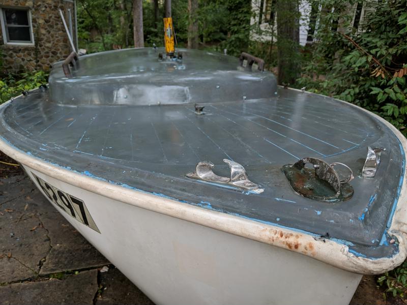

And I stripped all the flaking paint (3 layers!) from the topsides:
Stripped
There's still some paint in the "grooves" on the deck, I need to go back over this. Also doing some gelgoat repair:
Foredeck
In the meantime, someone local was selling a DS1 rudder. Since it was in much better shape than my rudder, I bought it and spent some time repairing dings and painting. My OCD tendencies are pushing me to reshape the top end of the blade (it's FLAT across the foreside of the first 3 inches or so.. seriously, O'Day?!?). But... need to calm down, my Falltime goal is to get the boat in the water, sailing. All I need for that are seats, actually just the centerboard thwarts. I have some nice tropical hardwood getting delivered today and am looking forward to making expensive wood chips.... :)

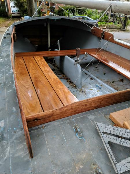

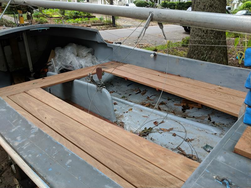

Postby tomodda » Tue Oct 16, 2018 3:16 pm
Cliff:
Here ya go:
New Seats
Honestly, I didn't want to show these till I got them all nicely oiled and purdy, but since you're asking.... :)
A few notes:
-I did these as planks because I like the look better. You can't see well from this angle, but the outermost and innermost planks are curved. The curve was the hardest part to do. The planks are connected to each other with three crosswise 1x1 strips underneath. Tropical hardwood (Cumaru), so plenty of strength. There are no supports for the seats other than the steel plate between seats and thwarts (underneath) and the cleats around the sides (bulkheads).
-If you blowup the photo a bit, you'll see that I have bronze "studs" holding the seats at the bulkheads. Those are actually bronze wood screws with a bronze "finishing washer", saves me the trouble of countersinking.
-I did not want to put any screws or countersinks, or plugs in the areas where I'd actually sit, so the connection to the centerboard and to the steel connecting plate are screwed in underneath the seats. This also is proving to be a pain... every screwhole needs to be pre-drilled and even though I test-fit, marked and pre-drilled the holes with the boards out of the boat, of course some are off. So now I have to drill and screw in a 10-inch space under the seat, not fun! Doable with an angle drill attachment, but my poor shoulders as I scrunch myself in there.... OK, first world problems :)
-On the positive side, I made these seats 16" wide instead of the original 12". I did some test measurements on my butt to come up with an ideal seat width :lol: The extra space makes them much more comfortable for sitting, Ok to lie down on (like a narrow single bed, but I've slept on worse before), and doesn't impede my legroom for putting feet down on the bilges, even up by the centerboard.
OK! Way more than you wanted to know about seats. I have to finish the underneath screwing (that sounds just wrong!) and then give it another light sanding and oil it (using Penofin Marine Oil). Then I'll post FINAL pics. Gotta clean the storm debris out of the bilges as well, always sump'n to do.

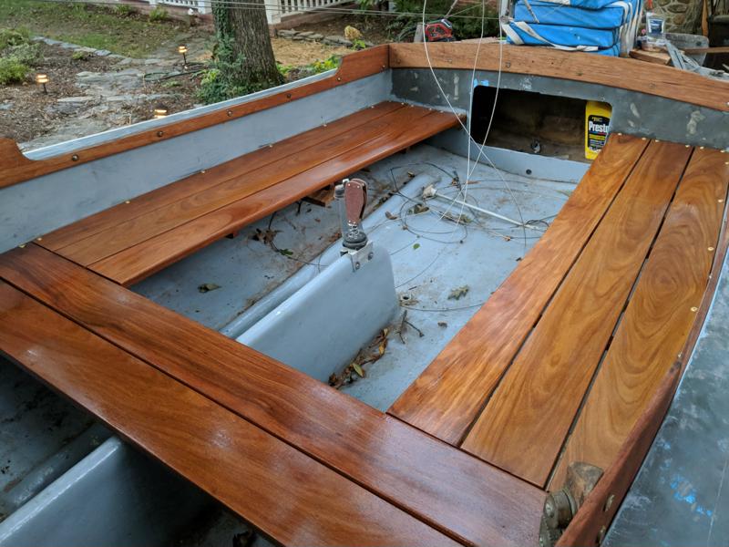

Finally! Seats are finished, properly screwed down and oiled. Coamings have also been sanded down to bare wood, cleaned and oiled. Yes, I went with marine oil (Penofin) rather than varnish or epoxy. Why? Varnish peels and is a royal pain to lay down (paint/sand/paint/sand/etc). And I'm getting pretty allergic to laminating epoxy in my young age... Of course, I'll have to re-apply the oil 2-3 times a year, but that's no big deal on such a small amount of wood. Anyway:
Seat and Coamings from Aft
And:
Seat and Coaming, Freshly Oiled
These photos show the seats still wet from fresh oil. After spending the night under a tarp, the oil dried / absorbed into the wood quite nicely, leaving a satin sheen. Next step is painting the decks and bulkheads, but that can wait (even though the boat looks like a peeled egg!). I'm very happy with the woodwork and ready to sail.
