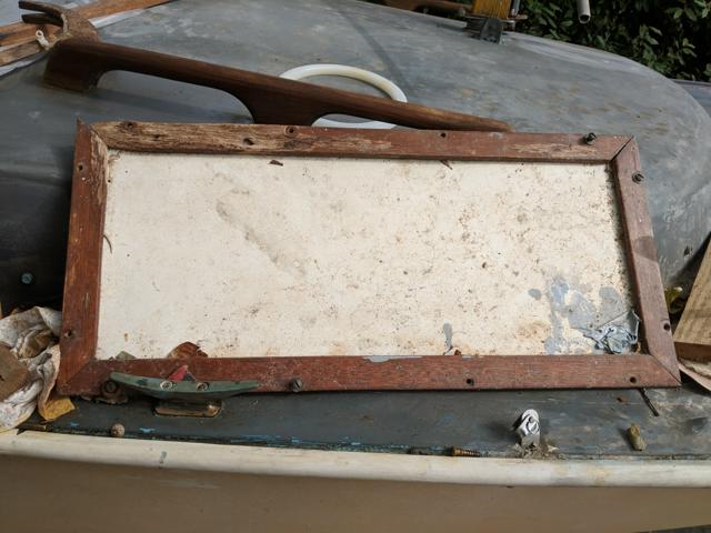

>>Looking at the stern bulkhead--is there a waterproof hatch?
Hardly! From the previous owner, I got a plywood sheet with a strip of 1/2x wood framing, falling apart from water damage. It screws over the hatch, utterly useless. Another winter-time project for me, I'm actually thinking of opening it up more, like the newer DS1's. My thinking is that I don't want to put a lot of weight that far aft and I want any water that gets in there to drain out fast. Good place to toss fenders, spare cushions, etc.. light, waterproof stuff. No waterproof hatch needed. Well, I'll take a snapshot of the sh*tty original hatch, just to scare you :)

So, here's a quick snap of the aft "hatch", it's actually just a rectangle of fiberglass, with a wood frame, screws to the hole in the aft bulkhead:
hatch cover

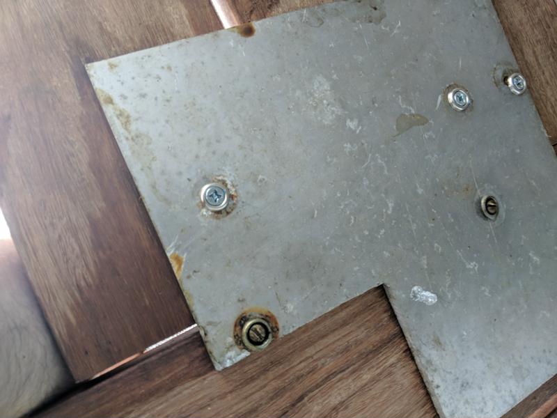

Here's the bracket connecting the seat to the thwarts. I took this photo by shoving the camera down there and clicking, I wasn't up to contorting myself in the bilges again (that's my wrist over on the left!). Suffice to say that this is an extreme close-up, but the dimensions are about 10" x 10" in an L-shape:
Seat Bracket

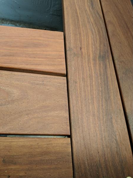

The bottom of this photo is the thwart-side, top are the seats. The bronze screws go into the thwarts (there's one more screw outside the frame of this photo) and the stainless ones go into the seat. No reason for the different screws, it's just what i had on hand. Seen from above (you can barely see the metal between the planks):
From Above
The thwarts are to the right in this photo.
That's it! Happy to answer any questions, but the connection is pretty straightforward. It's strong enough along with the cleats along the side walls that I don't need additional under-seat brackets, giving me a nice sweep of extra storage space. Dunno how I'm going to use it yet :)

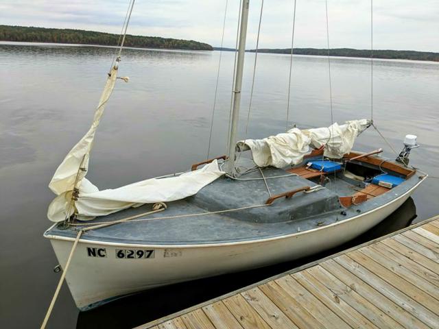

Been a long, cold, mostly rainy winter here in NC. As I've documented a bit in the repairs section of this forum, my friend has been kind enough to loan my his small barn for the winter and I've been painting (and sanding, and filling, and sanding some more). 99% of the folks on this forum are gonna hate my color choice, but it's actually pretty traditional, just not for a O'Day Daysailer... Anyway, a before pic, my last sail of the year and note the Electric Paddle hung on the stern:

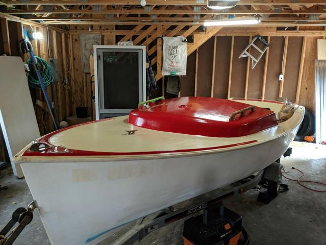

For the topsides, I decided to go with a buff/tan color to avoid being blinded by white decks in our Carolina summer sun. Likewise, anything dark would burn my butt when sitting out on the side decks, so tan it was. Hull is not painted yet in this pic:
Topsides painted

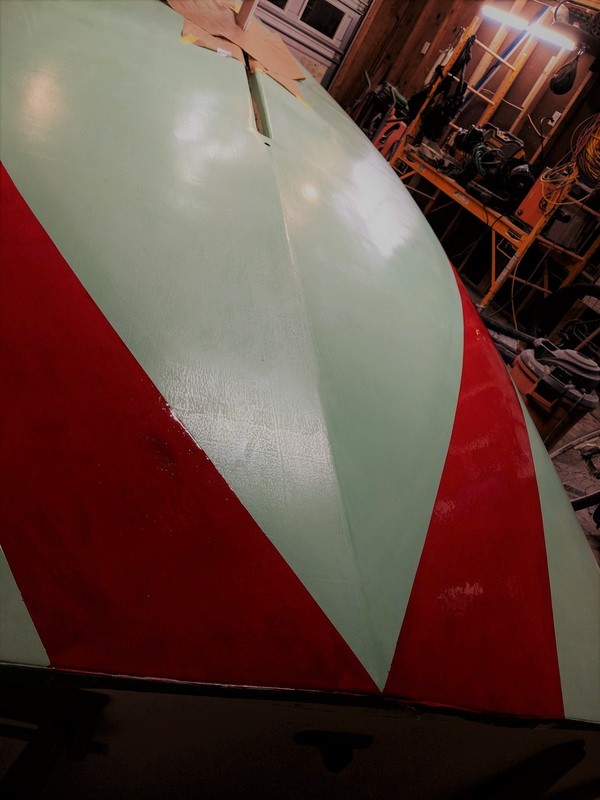

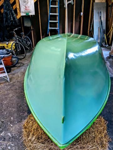

The rest are just complementary colors - Seafoam Green for the hull, and I LIKE red :). Anyway, here's the hull, flipped over and first coat of Seafoam applied (it's not quite as saturated in real life, the lighting was bad):
Flipped Hull Painted

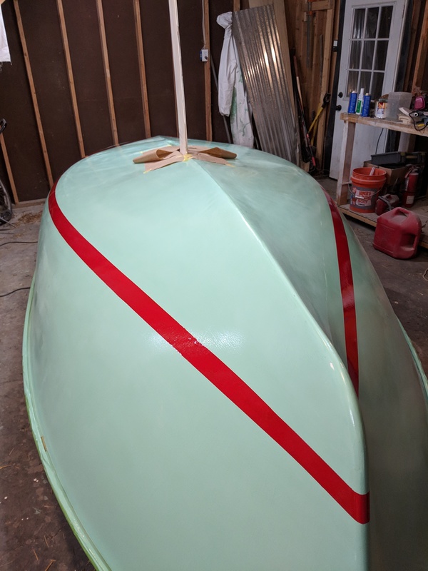

Most of it invisible to naked eye - more coats of paint, more sanding, more freezing my butt off in this unusually cold North Carolina winter. But, finally, something you all can see - waterline stripe!
Waterline Stripe 1
Even with the line molded into the hull, this was a royal pain in the "transom" to mask off. But now that it's done, let's admire it from all angles :)
Waterline Stripe 2
Ahem, yes, there's a roller mark that you'll see in the reflection right above the stripe. Dammit, I got careless towards the end on my last coat. More sanding, more painting :(
