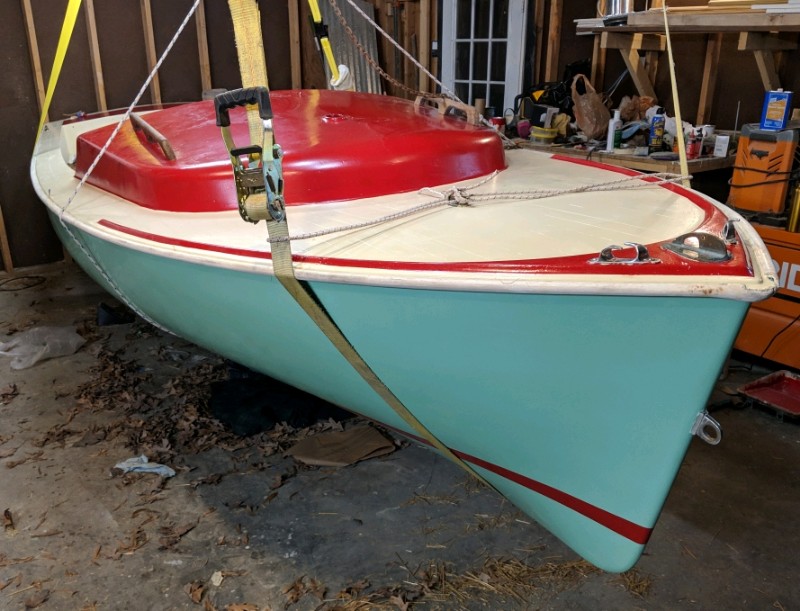

Right-side up
Yay! Finally done painting/sanding/compounding/waxing and here she is! Even managed to hoist her up and flip her back over. Been so long, I'd almost forgotten what the topsides look like.
Tomorrow... Trailer!

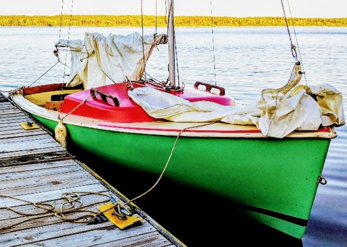

Some photos. In the backyard, all the wood bits back onboard:
Backyard
After a long day on the water. Sailed hard, and put away wet. :D :
On the Lake
I'm happy, was definitely worth all the blood, sweat, and paint fumes!
