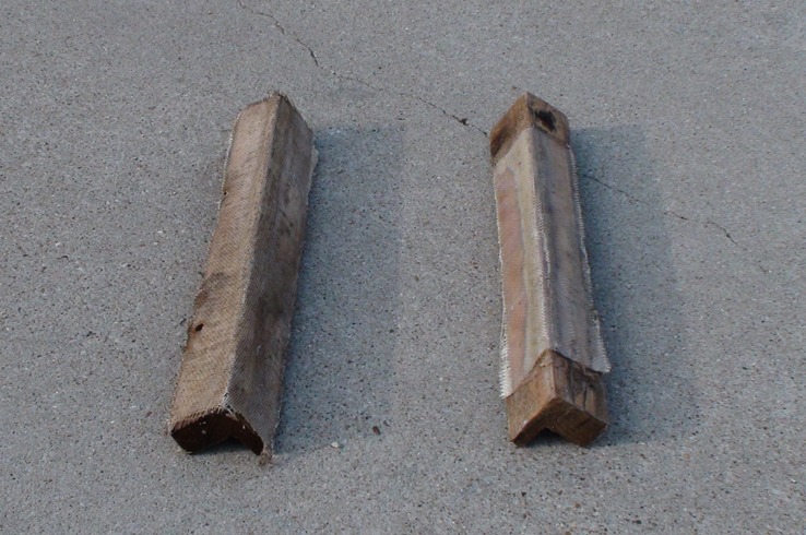

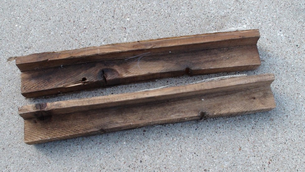

When I acquired by boat, my thwart screws were also very loose. After cutting the 6" inspection ports, I noticed the 7" or 8" long wooden blocks that had been "glassed" in inside the seats to "hold" the screws had broken loose. From what I can tell, it was just one layer of fabric holding each of them in. Since I've got about 1/2" of space between the end of the thwart and the seats on both sides, I figured this was why the wooden blocks had popped loose.
Back to the wooden blocks, they are kind of an "L" shape which fit exactly up against the inside of the seat where the screw holes are.
After examining the wooden blocks, it appears that when the thwart screws were installed, they went in between wooden block and the inside wall (laminate) of the seat tank. I've got thread marks on one side of the wooden blocks. I was expecting to see a perfect screw hole in each wooden block to hold a screw. It looked as if you had laid the screws against the wood and hit them with a hammer. An impression of half a screw.
Now, since the wooden blocks are out, when I look inside the seat, the screws are flat against the laminate on the inside (straight up and down). Now that it has come time to re-install the wooden blocks, do I try to re-align the thread impressions with the screws before I epoxy them in or start fresh and redrill the holes after I glass the wooden blocks in? I would install the blocks about 1" or so forward so the impressions wouldn't be there.

As long as your question clearly continues a discussion in an existing thread, I think there's nothing against reopening an older one. If you start what is essentially a new topic, you may find your post forcibly evicted and put out into the street (forum) under its own header. :shock:
If I understand your description correctly, you would epoxy the backing wood where it belongs. Then you would drill some pilot holes. Then you would put a few drops of epoxy into the holes. Then you would wax your screws and screw them in. With this technique, you get the epoxy to help form harder threads in the wood, and with the wax you still get the screws to come out later.
Or you forget about the epoxy and in ten or fifteen years, you find the screws pulling out, and then you pour some down there to try to restore the holding power - your choice. 8)

Definitely start with fresh holes. I suspect that the reason the blocks popped off was because they were wedged away from the seat tank laminate by the screws. If the blocks you have are still solid, I don't think you would need to worry about relocating them, just relocate where the holes are. Using epoxy, as you plan, should work well. I would think it would be a good idea to use thin epoxy to wet both surfaces and then use thick epoxy to make sure you have a solid bond. You should be able to use the screws to hold the block in place, just wax them so they don't get bonded with the epoxy.

Using existing holes= Epoxy the wood back in exactly the same position as it was removed.
Starting with fresh holes= Simply move (slide) the wood toward the stern 1/2 to 1", epoxy in place, let cure, and drill new holes in the wood.
In both cases it would be best to fill the screw holes with epoxy and coat the screws with mold release.
Would simply bonding the wood in with thickened epoxy, after wetting all surfaces out with thin epoxy be enough? Our should I put a layer of fabric behind it for "insurance?"

Okay, yes I would scoot it a half inch or an inch and drill fresh holes. I can't think of any reason to bother with putting cloth on. The thickened epoxy should fill up any spaces and give you a good bond.
