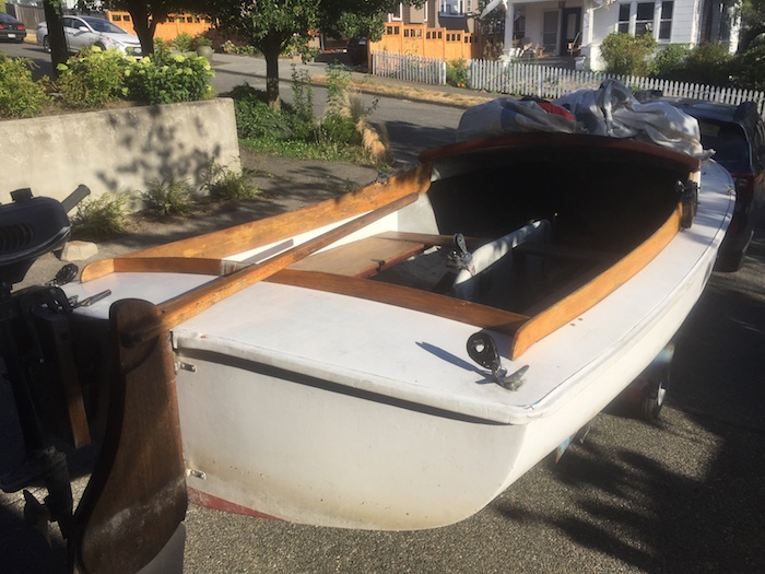

Here's a view of the boat on the trailer which shows more of the details:

Your boat looks like all the original Daysailer 1's I've seen with the wooden benches and the molded lines in the deck. Without a sail number it is hard to guess the year, but I would put it at around 1959. Overall it looks in good condition.

The shield next to the jib sheet cleats. A puzzlement.
Standup spinnaker blocks on the aft corners. Was this a racer, once upon a time?

And another puzzlement: The wood across the top of the cuddy opening. Doesn't appear in most DSI photos, but neither do the wooden benches.
OK, another one. What years did the outboard well appear/disappear?

This boat is an enigma for sure. Very early DS no doubt, with lots of "mods" along the way ...

We have the same vintage DS 1 at our club and over the years the hardware has been updated and modified which seems to be the case of your boat. Evidently the previous owner was a talented woodworker since all the wood seems recent along with a strip along the trailing edge of the cuddy...probably to cover up some damage to that area. The rudder cheeks and tiller also seem to be recent.
These boats were well built and the boat at our club is a very competitive racer

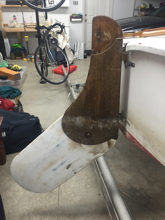

After some hack sawing I managed to take the rudder apart and turn it around. How does this look?
2015-07-23 20.36.09.jpg (143.16 KiB) Viewed 23649 times
Re: My first sailboat
PostPosted: Fri Jul 24, 2015 3:25 pm
Does it swing the 90 degrees?
Your bolt holding it is rather small, so it might take quite a bit of tightening to keep the rudder down by friction (perhaps that was the reason the PO reversed it ?? ).
Anyway, a downhaul could be rigged if it proves a problem. On mine, I need to use a pair of pliers to go a bit beyond finger tight on the wing nut, then it works fine.
