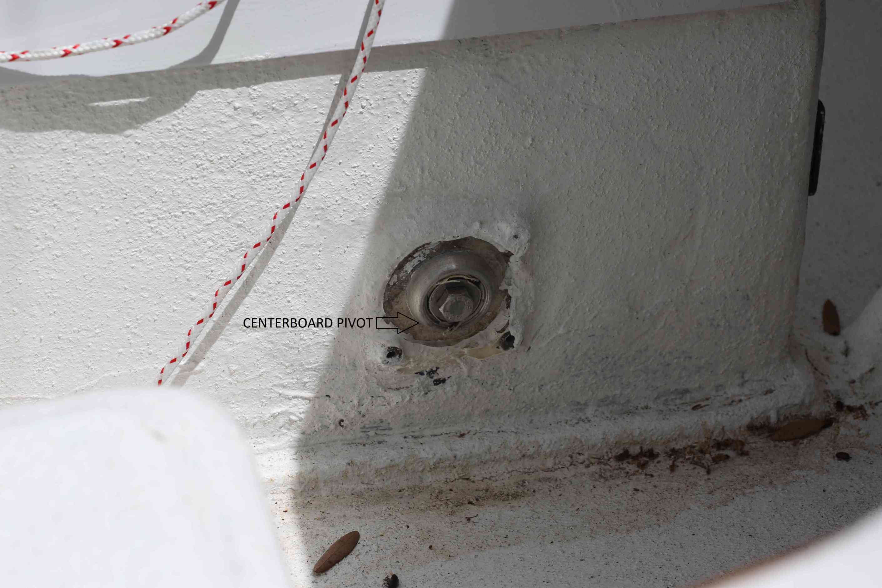

2. I do not have a locking mechanism for the centerboard, instead a PO or the factory has put 3 holes in the top of the CB trunk with jam cleats for 3/16” lines to hold the CB down and also to hold it up. Is this factory and is it workable? Should it be pinned?

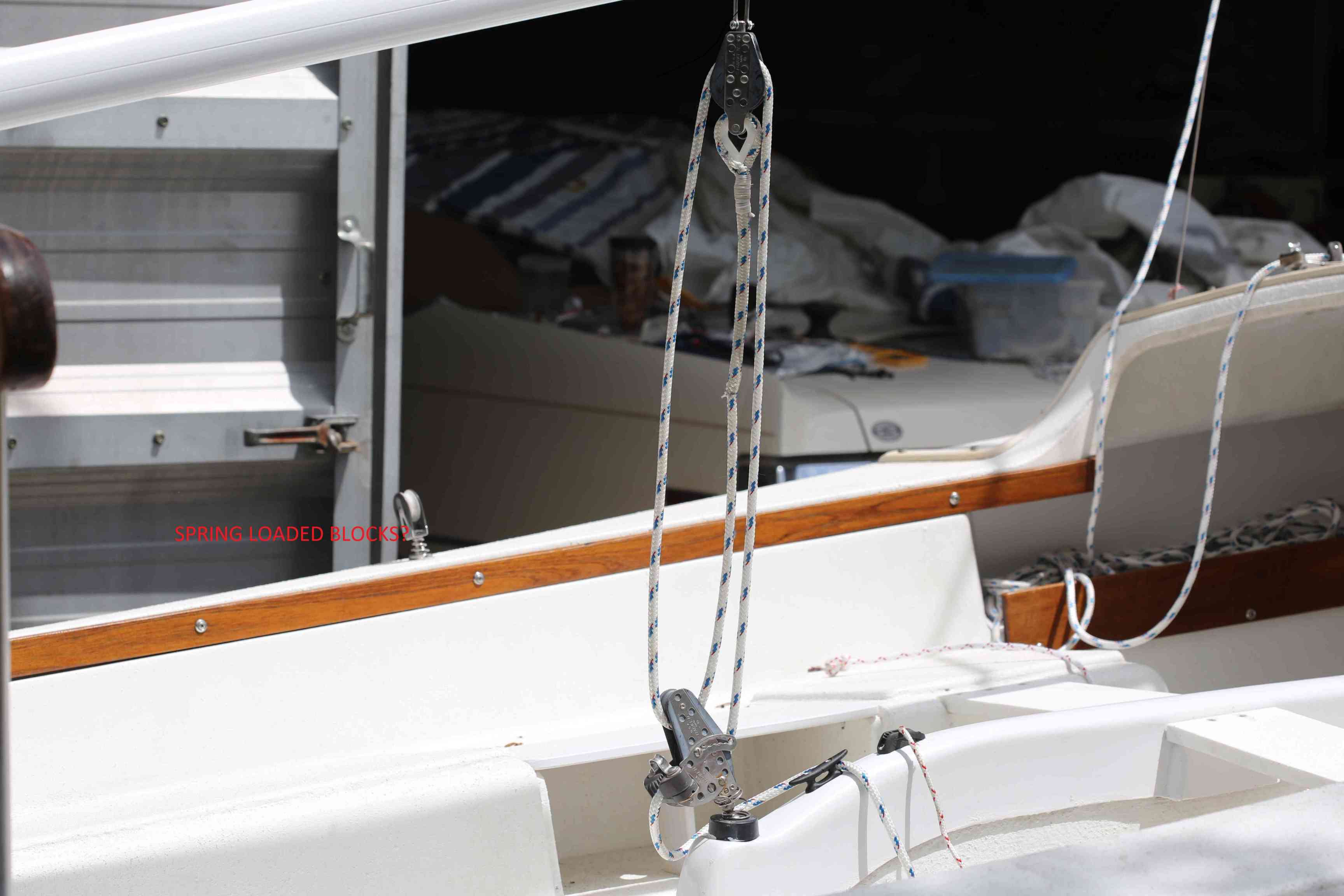

4. On the upper deck behind the seats, on each side of the vessel are is a spring loaded sheave, what are they for? It appears this boat uses a fixed traveler block, so what would these be for? Is it rigged incorrectly?

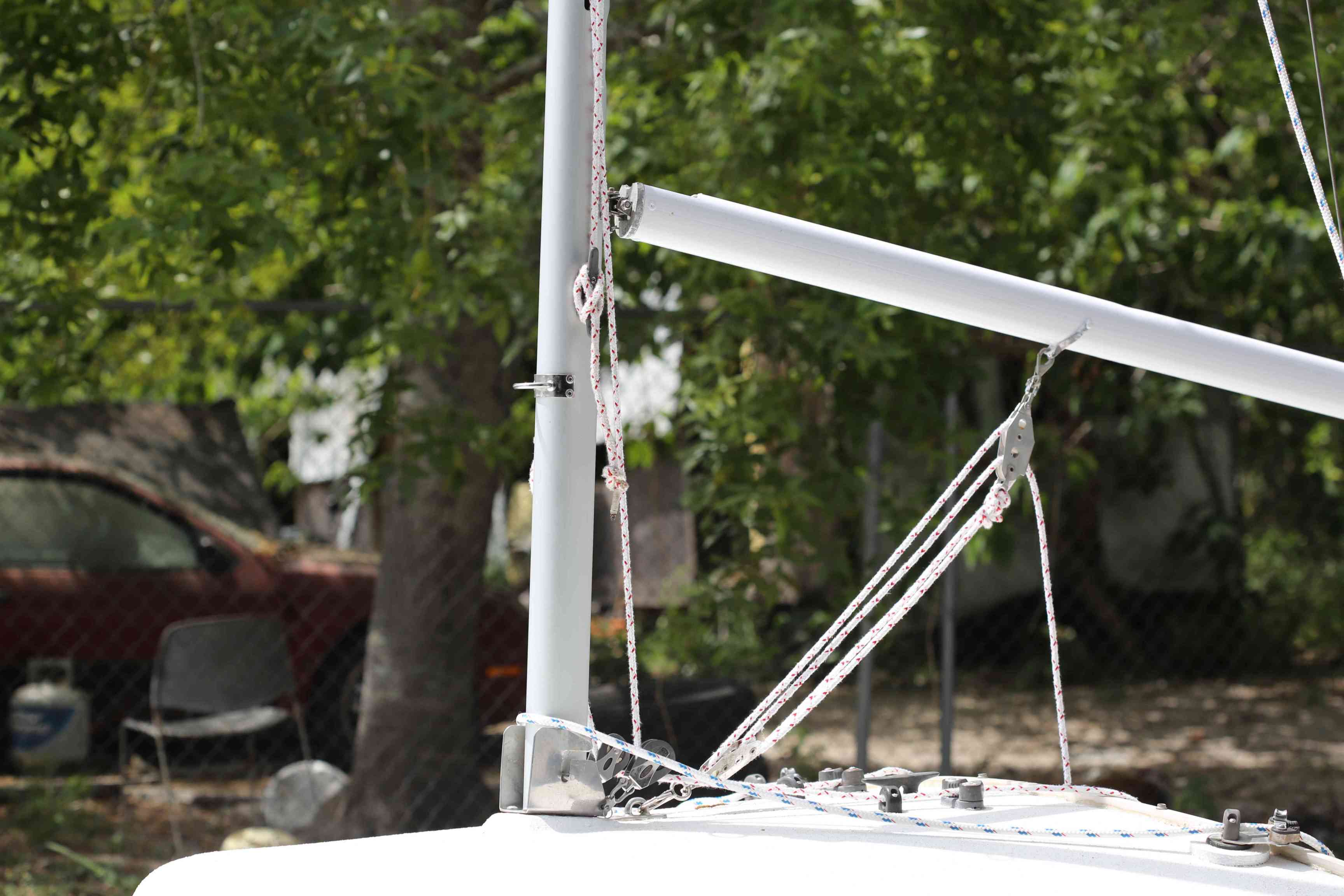

5. On the outer end of the boom are two little eye straps, what are they for?
6. On the forward part of the mast are two rings, what are they for?

Pivot for centerboard. No locking mechanism.
Traveller, jam cleat for holding CB up, Spring loaded block

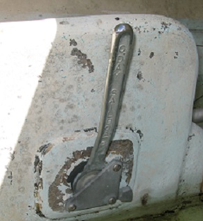

2. Your centerboard originally had a lever with a lock for raising and lowering the centerboard (see the 3 holes around the bolt to mount the lever). The lever was replaced by the more problematic line system of the Day Sailer II boats.

4. Maybe part of spinnaker rigging as they are at center of the cockpit.
5. Maybe part of a jiffy reef system, not really sure.
6. Those rings are the pad eyes for attaching a whisker pole or a spinnaker pole.

Viewing the photos: They're huge on the screen but if I left-click and drag the pointer (Windows laptop with a touchpad), I can pull a ghostly image of the subject out into middle of the photo. It looks, well, ghostly, but it works.
Having done that, it looks to me like you've the mainsheet installed where the boom vang should be and vice versa.

Boom vang and main sheet are in the right places, the boom vang just appears to be set up odd.

On closer inspection, I think you're right, John.
it looks to me like the boom vang is rigged upside down, that is, the adjusting line should be on the bottom. Anyway, that's how Harken shows them:

Postby GreenLake » Mon Apr 24, 2017 1:10 pm
I have mine mounted "upside down" as well.
With the setup as shown in the Harken literature, I can't easily uncleat the vang. With a setup similar to the one in the photo above, the vang is in better reach, esp. for single-handing.
A matter of preference.

Postby Alan » Mon Apr 24, 2017 2:07 pm
I can see why you'd want the vang cleat at the boom if you're single-handing because it would be farther aft and easier to reach (at least I think so - I'm 0-for-2 on guesses so far). :)
Now I'm trying to figure out how this particular vang is cleated.

Postby GreenLake » Mon Apr 24, 2017 10:33 pm
Mine is closest to the 8:1 cascaded fiddle setup, except the cam cleats at the one end are not 120 degrees, but only 90 degrees in relation to the direction of the vang and there's no way I could release them by pulling from a distance. Hence I mount them upside down.
The one in the picture above seems to have a V cleat.

Postby czbill » Mon Apr 24, 2017 10:48 pm
