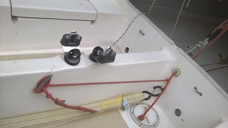

You'd probably want to put tracks on the inside of your coamings for the jib sheets and to rig barber inhauls for better sheeting angle.
A recent post from the person who put #8011 on the market had pictures that show a typical setup for the controls on the cuddy top:
Day Sailer #8011 CB jib blocks
CB system and jib blocks.jpg (143.23 KiB) Viewed 20553 times
Day Sailer #8011 cuddy top layout
Cuddy top labeled.jpg (182.04 KiB) Viewed 20553 times
Here's a picture of my jib tracks and upgrade to ratchet block as well as my rather jury-rigged spinnaker blocks (the setup was intended to be temporary to try out a "free" second-hand spinnaker, but worked so well, I haven't felt the need to rig anything more permanent).
