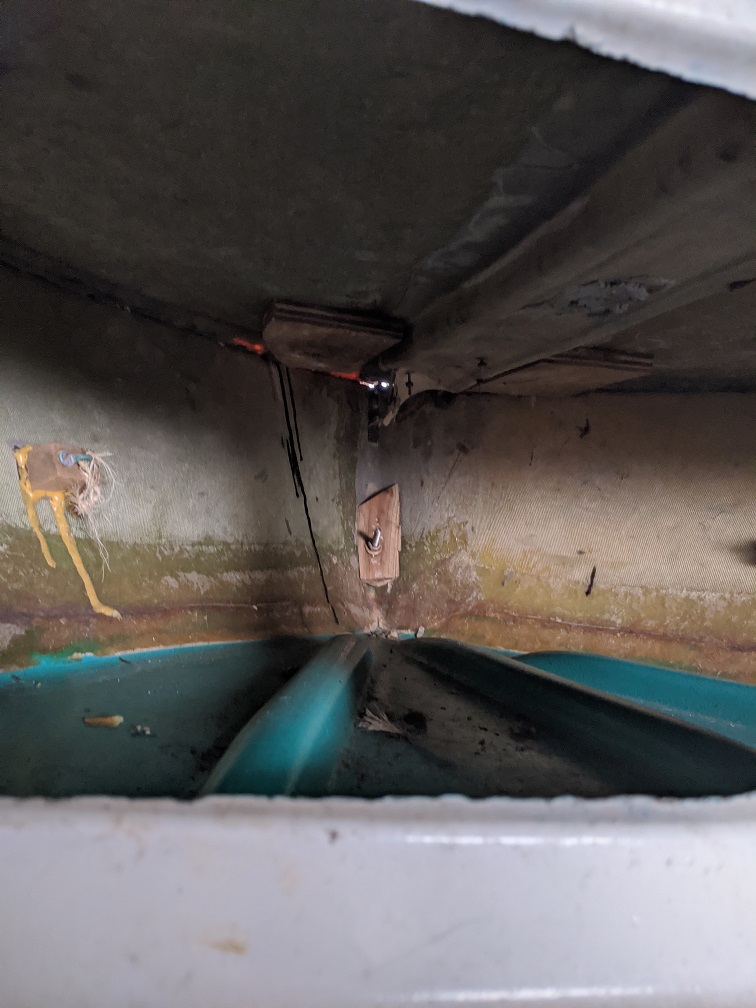

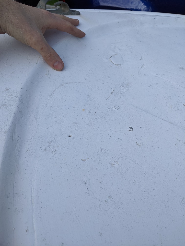

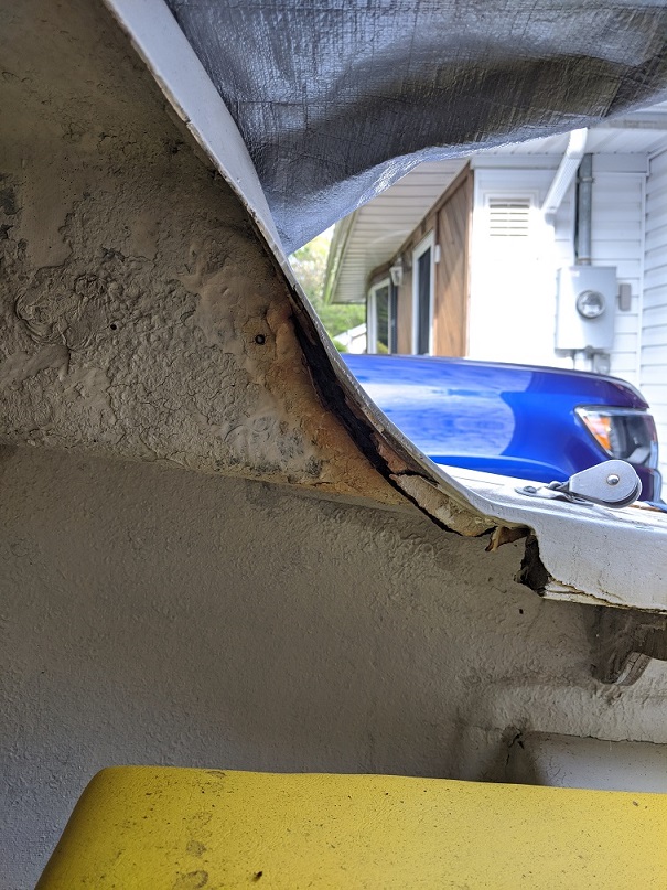

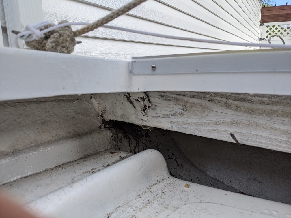

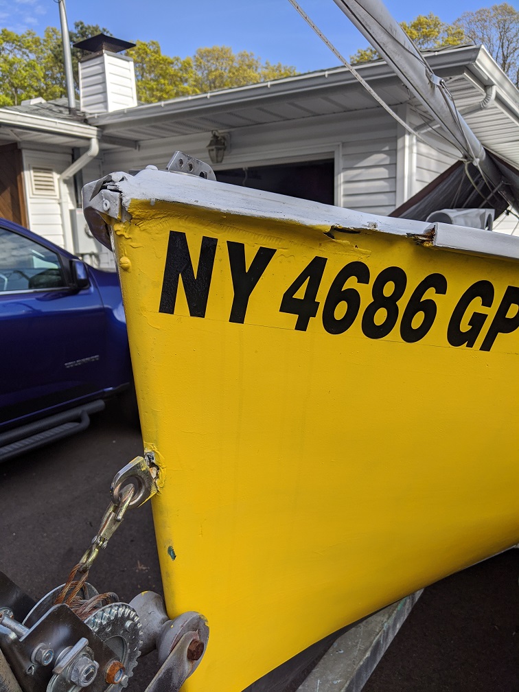

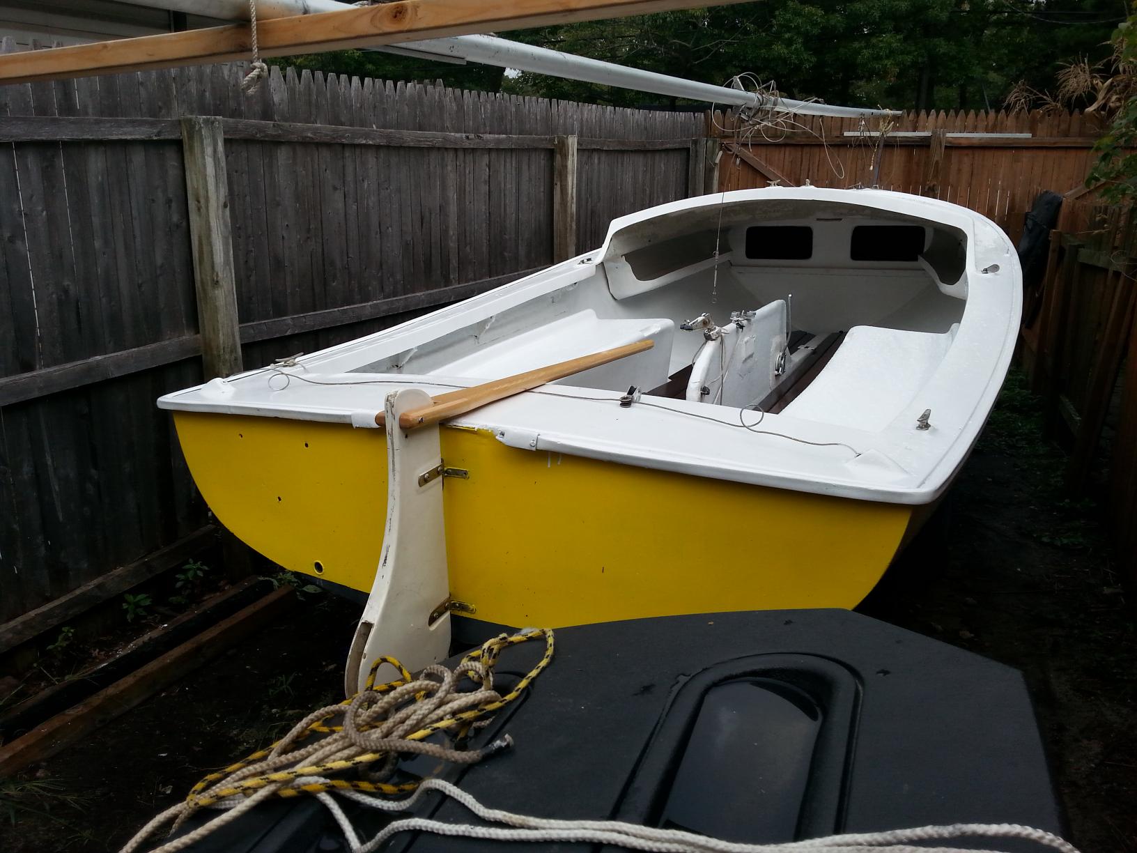

So I went to see the boat yesterday, and sadly I didn't have much luck. There were many DIY fiberglass repairs from a previous owner, some which concerned me more than others. The worst was the bow and foredeck, which had obviously had a hit long ago. Part of the bow rubrail was missing, the foredeck was separated from the hull, and the foredeck had some softness near the forestay with chipped and cracking paint (pics below). The tow hook was also loose and the hole was not at all watertight. The rest of the glass issues, like a transom repair that left a bunch of exposed wood, were more manageable, but this boat is more of a project than I'm willing to take on right now. Going to look at another boat today, but it's a DS2. Not my preference, but if it's sail ready it will be hard to say no!

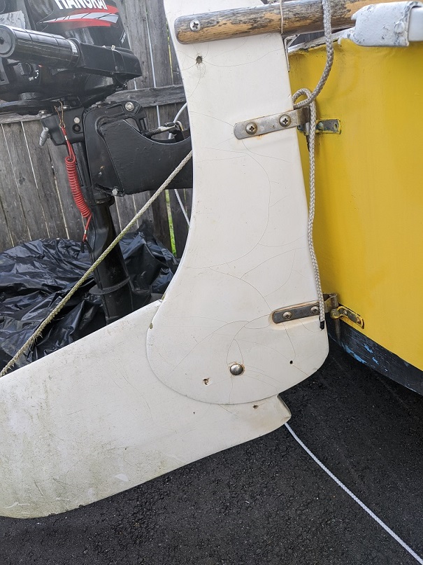

One question is about the rudder. (Pic below) The paint was pretty badly crazed and the bolts felt kinda wobbly. Is this servicable or should rudders like this be reglassed and rebolted?

Wow, looks like you dodged a bullet on this one, a definite hard pass, IMHO. Biggest problem is that the bow has lost it's structural integrity, so what's holding up the mast? The seller is DREAMING on the price...This is a sub $500 boat, as in the only value is in the trailer. The outboard is a $300 Chinese Mail-order two-stroke, no thanks. As for the rudder, I can't answer without poking at it myself. Sounds like the bolts need to be reseated indeed, but you can fix the crazing with any gelcoat repair kit. Still, you're in NY, there's other boats within driving distance. Keep your eye on Craigslist and sailing forums. Good luck!
Re: New member on the hunt! Please help!
Postby GreenLake » Mon May 18, 2020 2:48 pm
I would agree that this is a bit more of a project boat than it appears.
Rubrail replacement is best done like-for-like, but the rail, while you can get it, is expensive. (Unless you are prepared to do shell out for the part, or live with some compromise or with the piece missing, this one's the deal breaker).
It's clear that some PO rammed the boat into a pier/dock or whatever, but the bow in particular on these boats is super heavy laminate and can take quite a bit of abuse - the same is not true of the foredeck (if soft spots there, they can be fixed; looks like there was a "puncture" at one point). The stemhead fitting for the forestay should have an L bracket that is embedded in the fiberglass of the bow. On a boat like this, you'd want to double check that that connection is firm -- the deck is not intended to hold those loads.
Hull/deck separation may be an indicator that the forestay has pulled on the deck, but in this case, probably due to the impact. If I were to take on that boat, I would cut a large inspection port at the place the deck has had a repaired puncture (and when done, seal it with a circular deck plate). That would give better access to the stemhead fitting and also the place where the bow eye bolt is secured. Could be that the plywood backing has gone a bit soft, or just needs re-tightening. Would inspect the eye and bolt for cracks and then reattach w/ some caulking. If hole is oversize, perhaps narrow it down with a bit of fiberglass. Bow eye, I would consider "minor".
More of concern would be the cuddy opening, where the internal rebar has been allowed to be exposed, has rusted and now needs to be removed and replaced by something. Because the mast is keel-stepped, it would be possible to sail this even w/o doing the repair (deck only holds lateral loads). However, the deck no longer fully supports the weight of anyone standing on it (and someone is always standing on mine, so that one is a must fix in my view).
Repairable with either hardwood beam or a hollow fiberglass structure. Not costly, by time consuming. If that work is done, it would be beneficial to extend the support so it becomes a "ring"; that would stiffen the boat in that area.
Rudder would need to be replaced/rebuilt. Making your own isn't that hard and you can get something that has better foil shape and less drag. See thread Building a Rudder.
CB is not shown - I would expect it's state to roughly match that of the rudder (on general principle). You can make your own w/ moderate cost/effort, and result would be "better than new" (better foil shape). So if inclined to work on your new boat I would not pass up one of these for issues with foils.
