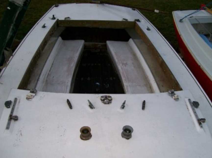

I've thought about moving my jib cars to the top of the rail, but I can see a problem trying to sit there. I recently re-did my tracks as the wood backing was rotted and the tracks were coming loose. I was wondering if the Jib cars would work on the cuddy cabin top like they do on the Rhodes 19.
The cam cleats and fairleads are mounted on swivels.

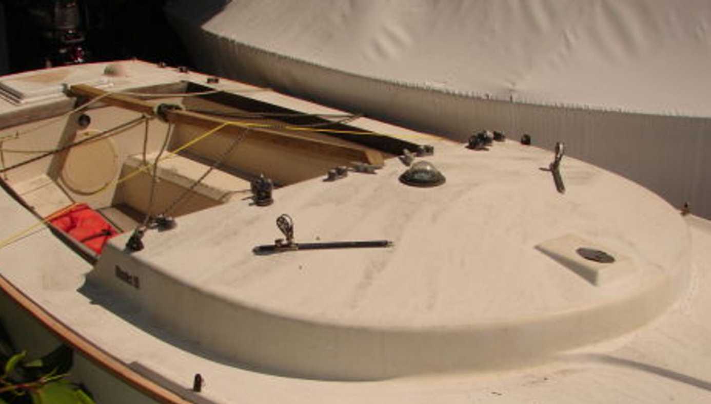

The picture I posted earlier was from a 1960's vintage Rhodes 19. Attached is a picture showing the current position. I think the R19 track acts as a barber inhauler. The Mariners have the jib tracks in the same place as the early R19.
R19 Jib Cars - Current.jpg (50.71 KiB) Viewed 17147 times

Those pictures are not of my boats. Just some examples I found of the R19 jib tracks. Wish I could afford expensive covers like that. I go with tarps that the Texas sun quickly destroys instead.

K.C., Tom, John, much appreciation for the info. K.C., that's a good point about sitting out. And Tom, that's a good point about being able to switch the cars from one track to the other. And the cuddy-top setup that John photographed looks like it might be just the ticket.
