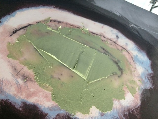

So the fairing went well I think. I ended up mostly using a 12" tape knife as that was wider than the repair and helped "stuff" the QuickFair into the depression still left from my fiberglass repair. Still need to try out my sandy board and do the neat epoxy.
Faired (Small).JPG (78.75 KiB) Viewed 511249 times
