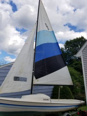

I recently purchased a DSII (1983) with the Neil Pryde main white, black, bright blue, light blue, white sail as pictured.
Rigged on trailer_0t20lM_600x450.jpg (19.56 KiB) Viewed 7654 times
Elastic for the third batten pocket (from the top) was shot and I was reviewing DIY redos this weekend when my sister emailed to say that that batten flew out of the sail into Little Narragansett Bay (CT/RI). Reading my handy-dandy manual from Roger Conrad (that I had bound into a great little book), the paragraph (8.9) on battens says that the max length is 40.5". I'd rather buy a new batten than glue narrowed paint sticks together.
Looking for reassurance and a little input on my plan.
Defender sells Bete-Fleming 3' and 5' battens so I guess I need to buy the 5' (and two caps) — for about $12 — cut it down to proper length and super glue on the caps. One drop each I read. (I will go in person so no S/H.)
Width: Battens that came with the sail appeared to be 5/8" and GreenLake suggests that the 5/8" should be fine, so I guess that's what I'll do. (I will also scrounge around in the barn to see if something should turn up for free.)
