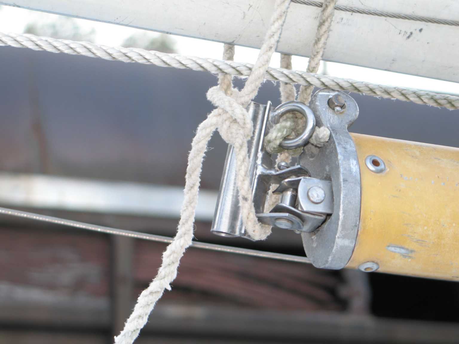

Postby jeadstx » Thu Oct 03, 2013 3:45 pm
Here is the end of my boom.
Boom End.jpg (91.38 KiB) Viewed 10402 times

Postby Interim » Thu Oct 03, 2013 3:49 pm
Looks like mine, but for the fastener. Perhaps this is my excuse to buy a rivet gun.

Postby GreenLake » Thu Oct 03, 2013 8:17 pm
Nice picture. Mine looks the same (from memory), so apparently no design changes between '63 and your date or one of us doesn't have the original boom...

Postby Interim » Tue Oct 08, 2013 11:17 am
I have a 1979 DSII, which I am trying to get in order for the Spring.
John's picture shows a third rivet. That is, if there is one each on the long sides, there is a third on the short side (opposite the slot). (Mathematicians; sorry for referring to the sides on what is obviously an ellipse).
Mine only has the two on the long sides, so I plan to put in a third. Does the type of metal used in the rivet matter? I understand Greenlake's note about type of stainless steel, but I have this lingering idea that I can create problems by putting the wrong types of metal next to each other. Is that right, or does the 316 SS work ok on an aluminum boom?

Postby GreenLake » Tue Oct 08, 2013 4:21 pm
Boom and end cap are aluminum. To avoid galvanic corrosion you can either use aluminum rivets or use SS fasteners with TefGel (an insulating paste). TefGel is a bit pricy but a really small quantity will last you a long time..
