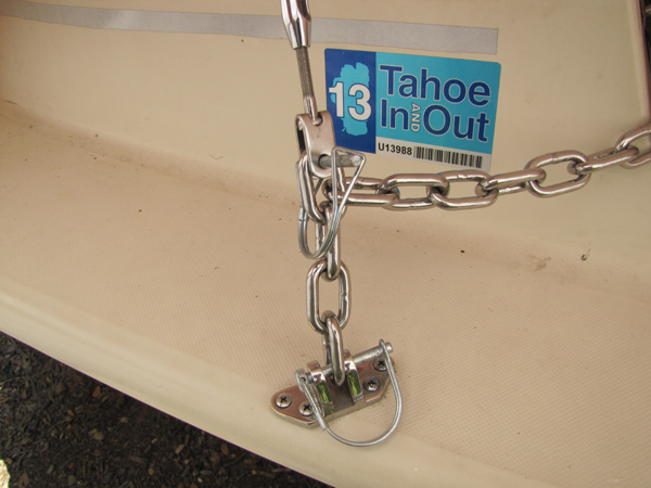

Postby Alan » Wed May 28, 2014 6:18 pm
Here are the photos of one of the heavy-duty chainplates I concocted (port side shown). I'm in the process of lengthening my too-short mast, which means I need extensions from the lower ends of the shrouds to the chainplates. I'm using links from my anchor chain, 1/4-inch stainless. I haven't cut the chain yet because for some reason, I need four links on the port side and five links on the starboard side, even though the mast looks vertical when viewed from the stern.
The extended mast is the result of a lengthened stub, which I installed because the forestay and shrouds were sloppy loose even with the turnbuckles shortened all the way. The lengthening places the lower edges of the spreader brackets at exactly 7 feet 8 inches from the top of the cuddy (the class specification). Why I need extensions if the spreader bracket height is correct is a mystery, but they work, so what the heck?
Port chainplate.jpg (191.84 KiB) Viewed 29355 times
The chainplate is actually half of a hinge. It uses four No. 10 screws with self-locking nuts.

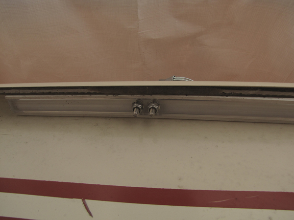

Chainplate reinforcerment - outer.jpg (144.76 KiB) Viewed 29355 times
The outer two screws pass through the hull-deck joint lip. The reinforcing plate is made of 1/2-inch plastic half-round rod that I got from TAP Plastics, with a split section of 1/2-inch PVC pipe around it to enlarge the diameter so it fits exactly inside the lip. The Schedule 40 pipe I used is a bit too thick, so I need to replace it with the thinner stuff (Schedule 125, I think).

Postby GreenLake » Thu May 29, 2014 1:59 am
Lots of interesting detail that I would not have guessed without the pictures.
About the mast being vertical - hang a weight from a halyard (when the boat is level) and you will see. Or better yet, take the same halyard from one chain-plate to another - should be the same distance.
