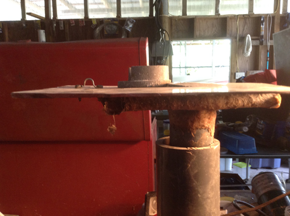

You could always just order an extrusion from Dwyer that's the length you want for the stub? Seems easier than fussing with the step, which is screwed into a piece of wood (plywood?) that's glassed in between the compression post and cuddy sole. Reason I know this is because ChrisB had to cut out a section of his, due to a mis-aligned post that caused a crack in the sole:
Cutout Side View2.jpg (187.76 KiB) Viewed 18583 times
As far as the turnbuckles go, the new stays come with the threaded studs already swaged on, so as long as your existing turnbuckle bodies fit those, you could use them.
