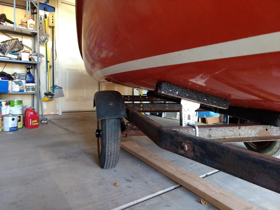

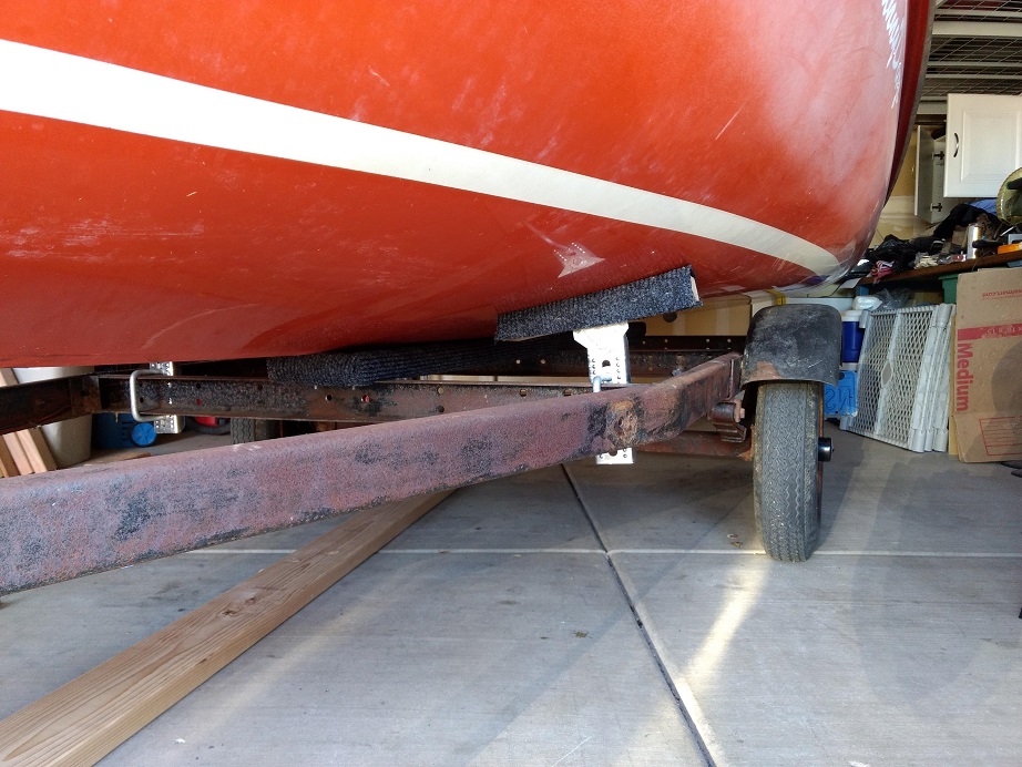

I picked up Sunny Daze in September, my first DS, and have slowly been working on the trailer. I was going to pretty much copy what Zinger88 did, but after I got the center bunk on the trailer, I ran out of time for the day, and quickly made up 2 temporary small bunks to keep the boat level. The two small bunks are positioned right where the bulkhead is, and they do a good job keeping the boat level. Now I'm considering not even adding side bunks, since these small ones seem to be doing the job. What do you all think? Is this a good idea? or should I add the long side bunks as well.
When I got Sunny Daze all the weight of the boat was on the side bunks, the keel wasn't resting on the center line rollers at all except for the bow, so the hull had some oil canning going on.

Postby GreenLake » Sun Feb 02, 2020 1:09 am
The setup you have as you show it is almost the worst possible configuration. The only thing worse would be a bare broomstick (point load).
Yes, they keep the boat level, but whatever loads they do support would be very concentrated. If the boat rests on the keel, it may be that you can place these low enough to they don't take too much weight, but that won't work when the trailer is in motion (and it will tend to pull the boat open, if it rests only on its keel).
Get another pair of those little support brackets and mount them in the back, then connect with some boards that are 8-12" wide and backed by a "spine" of 2x4 of 2x6 to stiffen them a bit. Not that much work and your boat might avoid some "dimples".
PS: it's not just the dimples you see when there's static load, but when you trailer, the laminate is flexed at the edge of the support and will quickly get weak.

Postby EricJ » Sun Feb 02, 2020 1:35 pm
GreenLake wrote:The setup you have as you show it is almost the worst possible configuration. The only thing worse would be a bare broomstick (point load).
Thanks for the feedback! I'll continue with Zinger88's configuration!
