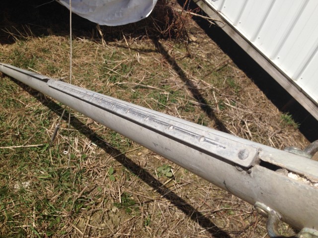

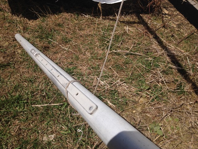

The two tracks that you observe are for the boom and for some spinnaker or whisker pole (if the "track" on the front end of the mast is about 10-20" long).
The DS is used with spinnaker poles mounted to a ring (or two, if you want a choice in positions). Unless you have a spinnaker pole that works with the track on your old mast, I would not bother with reinstalling it and switch to a ring (if you ever want to fly a spinnaker that is, or use a whisker pole).

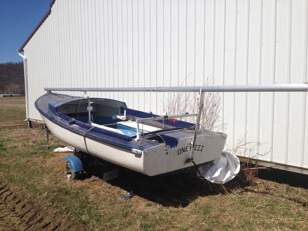

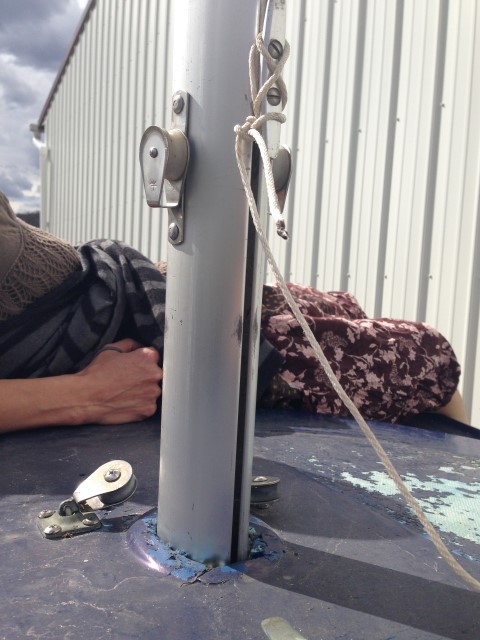

On your new mast, I see only one block (for the jib) near the spreader location, and I don't see a mast ring. I see some small fittings at half the spreader height on the side of the mast, not sure what those would be. Detail picture?

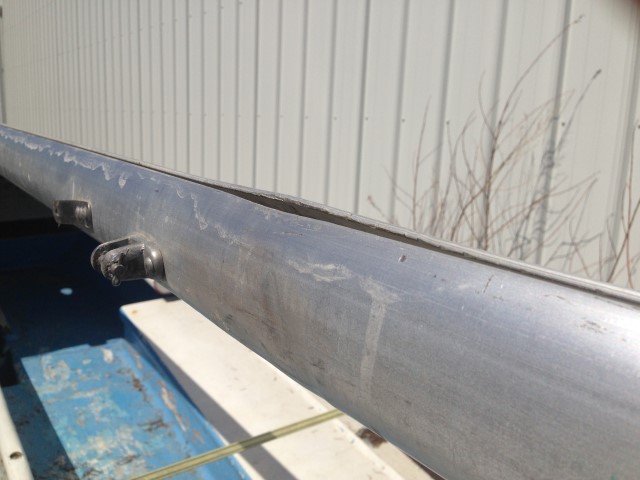

I take it (hard to see from your pictures) that the sail that you have sets in the same kind of slot that you have in the new mast, with only the gooseneck riding on the track. In that case you should be able to move the track over to your new mast. The widening of the sail slot that you show looks like the mast got bent at one point. Assuming that it was carefully straightened and shows no other sign of stress, I'd expect it to be fine. I don't think you should have any problems raising the sail and I don't think it will "pull out" at that spot (not if the luff is tensioned correctly) so you may find this a cosmetic defect only.

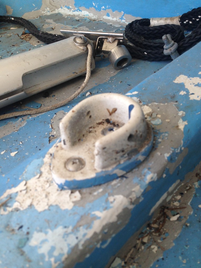

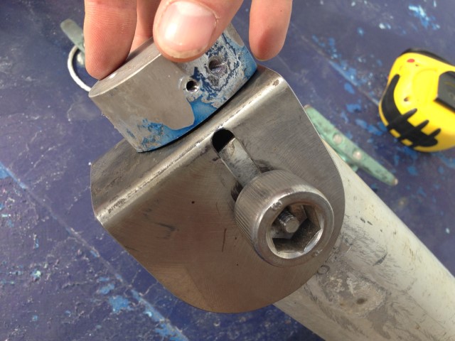

One of the pictures shows o the floor of the boat somethings that looks like a sliding gooseneck. I guess, what we are seeing is one end of the boom. The screw seems to attach to a bit of line intended to go through the tack of the sail? The DS boom has a pin for that purpose.

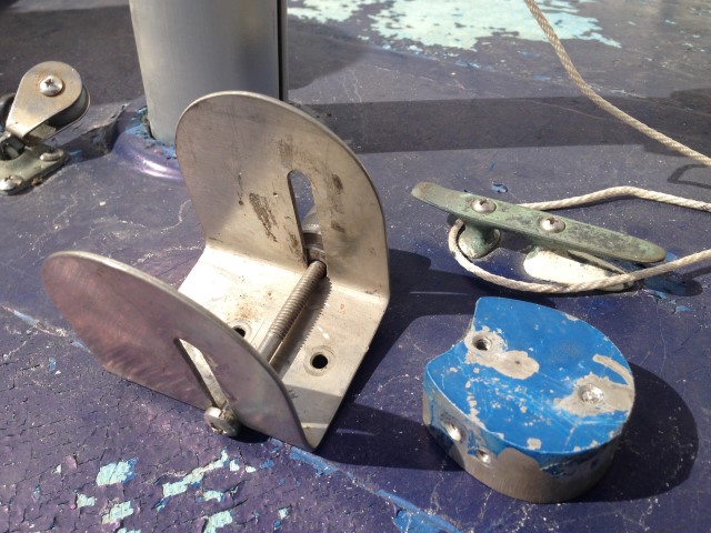

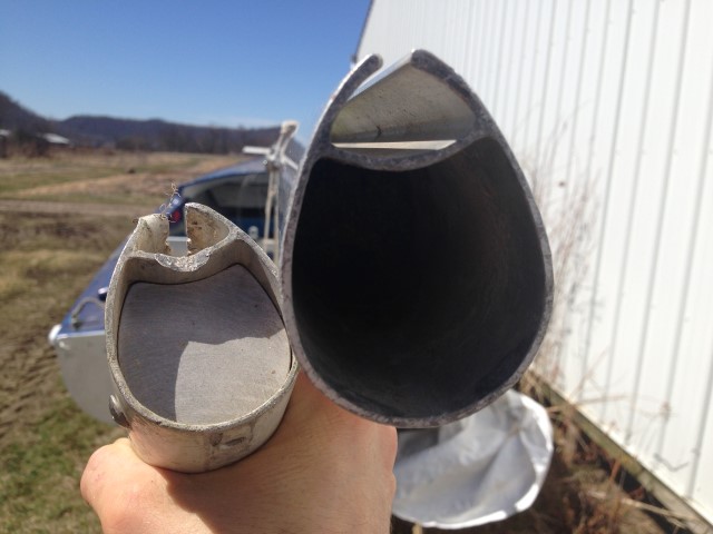

Since the mast profiles appear to be the same, your tabernacle should work: the oval piece should hold the upper part of the mast in place, and everything is supported by that rather massive plate. Do the slots allow the arrangement to hinge? If not, you may find a hinge more convenient.

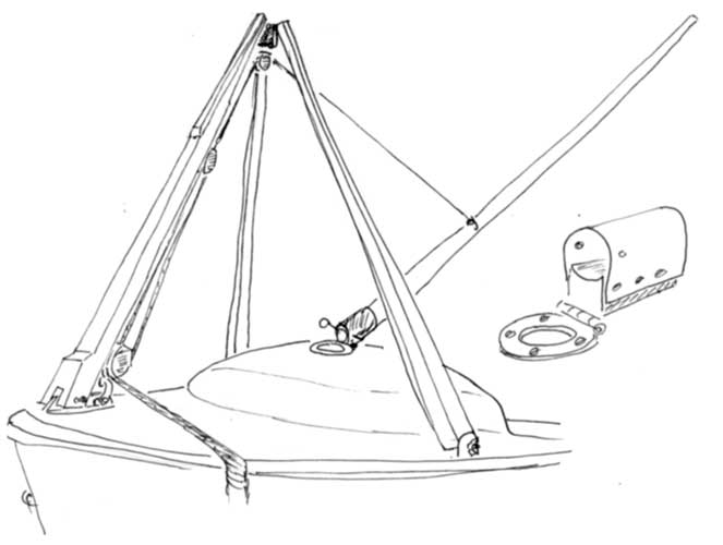

Also, there's nothing inherently wrong with using a keel-stepped mast. You've already managed to insert it once. There's a bit of home-made gear I have on mine that makes that process easier. You could retrofit that and never have to cut your mast. (Purists find that keel-stepped masts sail better).
Here are a few pictures:

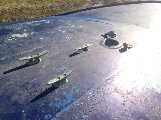

What you see is a circular base, a gate hinge, a wooden block and a bit of aluminum sheet metal forming a sleeve. You start with the thing folded down, insert the first 6" or so of the mast into the sleeve, hinge it into vertical position and then drop it onto the mast step. Something I can easily do single-handed. You appear to have enough clearance between deck and the lowest cleat to allow for such a contraption.
(You will also note the bent aluminum strip around the front of the disk: it's there to keep the jib sheet out.)
The place where I stashed the full write-up appears to be temporarily or perhaps permanently offline: here's at least the drawing.
- MastRaiserDrwg.jpg (21.93 KiB) Viewed 38408 times
The hinge is the large detail on the right. Also shown is an A-frame that can be used by anyone, no matter how short/tall, to raise a mast. (I built one and then decided to retire it until I'm old enough to need the extra support).
