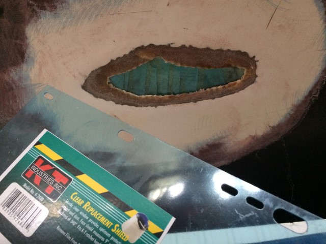

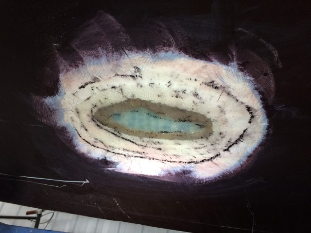

Postby marcusg » Sat Aug 22, 2020 3:47 pm
So I did my test patch the other day on a piece of plywood, and it was so easy I wondered why I'd been procrastinating the project so long :P
Today I did the real thing. I had trouble finding "retail display plastic" as Greenlake suggested, at least big enough to cover the patch, so I ended up buying a replacement plastic face shield, and that worked great. I ended up cutting it in a half dozen or so slices and shingling them on top of each other between the hull and foam.
Face shield.JPG (97.45 KiB) Viewed 16733 times
For my patch, I initially planned to do five layers, which I just sort of randomly guessed would be enough. I alternated 6 oz cloth and 1 oz matting, for 3 of cloth and 2 matting. I might have started too far beyond the hole than I was supposed to, as I only really "graded" for about 2" around the hole, but my biggest patches started much beyond that. I dunno. Either way, by the time I got to my last two patches, I realized there was still a ton of room left to "fill" the hole, so I panicked and proceeded to tear off my gloves a few times, mix new epoxy, and cut new patches to fill the hole. In the end I ended up having, I think, 9 total patches, 7 of them cloth and then those initial 2 CSM sandwhiched between the bigger layers. There's still a bit of an indent where the hole was, so I'm guessing that if 9 layers of glass didn't do it, then the contour isn't supposed to be perfect yet and I can fix that up with the fairing stage?
I was a bit worried about the indent, and I also, in my rush to work before the glass on the boat started curing, wasn't super careful in cutting my last-second patches so that they did they China-doll one inside the other thing. They were roughly similar sizes and may have overlapped the wrong ways sometimes. But overall it worked well. It was scary working up side down wearing only a t-shirt as the epoxy dripped!

Postby GreenLake » Sat Aug 22, 2020 4:26 pm
Marcus, that sounds about par for the course. I think your repair will turn out fine and strong despite the momentary panic while in the middle of it. If your repair is proud of the surface, try to scrape or grind away the surplus as soon as the epoxy is hard enough to resist the tool - it will be a bit easier than waiting for it to be fully cured. But even then, you should have no problem leveling it.
At 9 layers, the middle of your patch would seem to be stronger than the original hull section. Did you push the center in? Never mind. Just clean and fair and paint over it. Good job!
