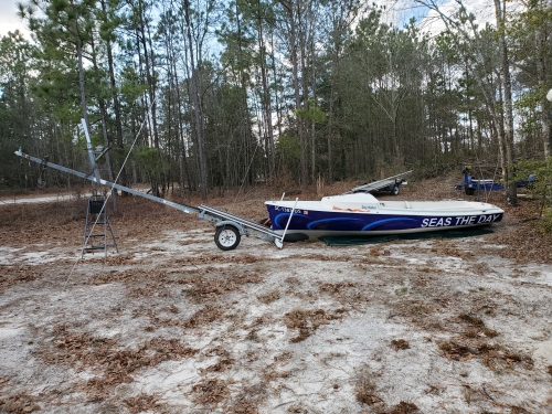

My trailer sits on sandy ground. It was a bear to move because there was so much weight on the jack. I did some research and found that the tongue weight should be around 7% of the total weight of the boat and trailer. Mine was 150lbs when it should have been 60-70lbs. I had to slide the boat back about 2 feet to achieve the correct weight. Now the boat sits more centered, fore and aft, on the bunks. The centerboard now sits on a keel roller. I thought it might make the boat easier to launch and load, but no joy.

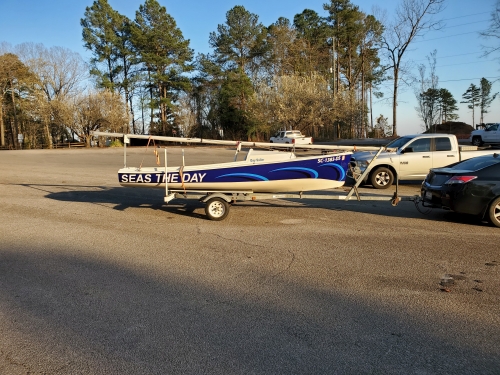

These are the things I checked and adjusted on my trailer to make it easier to launch and land:
1. Make sure the boat is in the correct position fore/aft. The tongue weight should be 7-10% of the total weight of the trailer and boat. That's going to be 60-100lbs for us. Mine was about 150-200lbs when I first checked. I moved the winch bracket and the boat further back until the tongue weight was correct.
2. Make sure the trailer is level. Ball hitch brackets come in different "drops". Mine needed to be raised 5in.
3. Make sure the bunks are parallel and, preferably, tilted towards the center to match the angle of the hull. Mine were neither.
4. Spread the weight across the keel rollers and bunks. With the boat resting on the keel rollers, I pressed up on the bunks while tightening the bunk brackets.
5. Position the keel rollers and bunks to be slightly higher in the front. It helps a small amount with launching/landing without causing problems while on the road.
Notes:
I replaced my 2x4/carpet bunks with 1x6s and Trex. My first impression is positive. I'll be interested to see how this works out over the long term.
The hull curves fore/aft and side-to-side. It won't have full length/width contact with a flat 6in by 6ft bunk.
The hull is narrow at the front and doesn't come in contact with the bunks. It rides on the keel rollers.
My keel rollers are squared-off "V"s. They straddle the centerboard slot. The aft end of the centerboard rests in the groove of one of the rollers. I wrapped some indoor/outdoor carpet around the last cross-member to keep it from scraping the aft end of the centerboard in case it is hanging low.

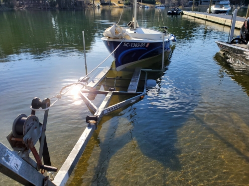

I took my newly configured trailer for a test drive today. I am pleased with the results. My feet did get wet but that was about all. :D I backed the trailer in until the aft end of the bunks were about 2in below water. I was able to push the boat off of the trailer, walk down the bunks and climb aboard. For landing, I guided the boat to the ends of the bunks, climbed off with the bowline in hand, walked up the bunks, attached the winch strap to the bow and used the winch to pull the boat onto the trailer. This was, by far, the easiest launch and landing I have done.

There aren't many sailboats in this part of the country (and no DS Fleets). The two ramps I have tried are not "sailboat friendly." Both of them have shallow rock fields on either side of the ramps, probably to prevent erosion. Pulling the boat from the trailer to the first dock is not practical. The other, as seen in the picture, has two ramps. The one closest to the dock has a low overhanging tree. It is rare that there is no one launching/landing their powerboat between me and the dock. Climbing on/off from the trailer is a necessity for me. I'm glad you have other choices.
