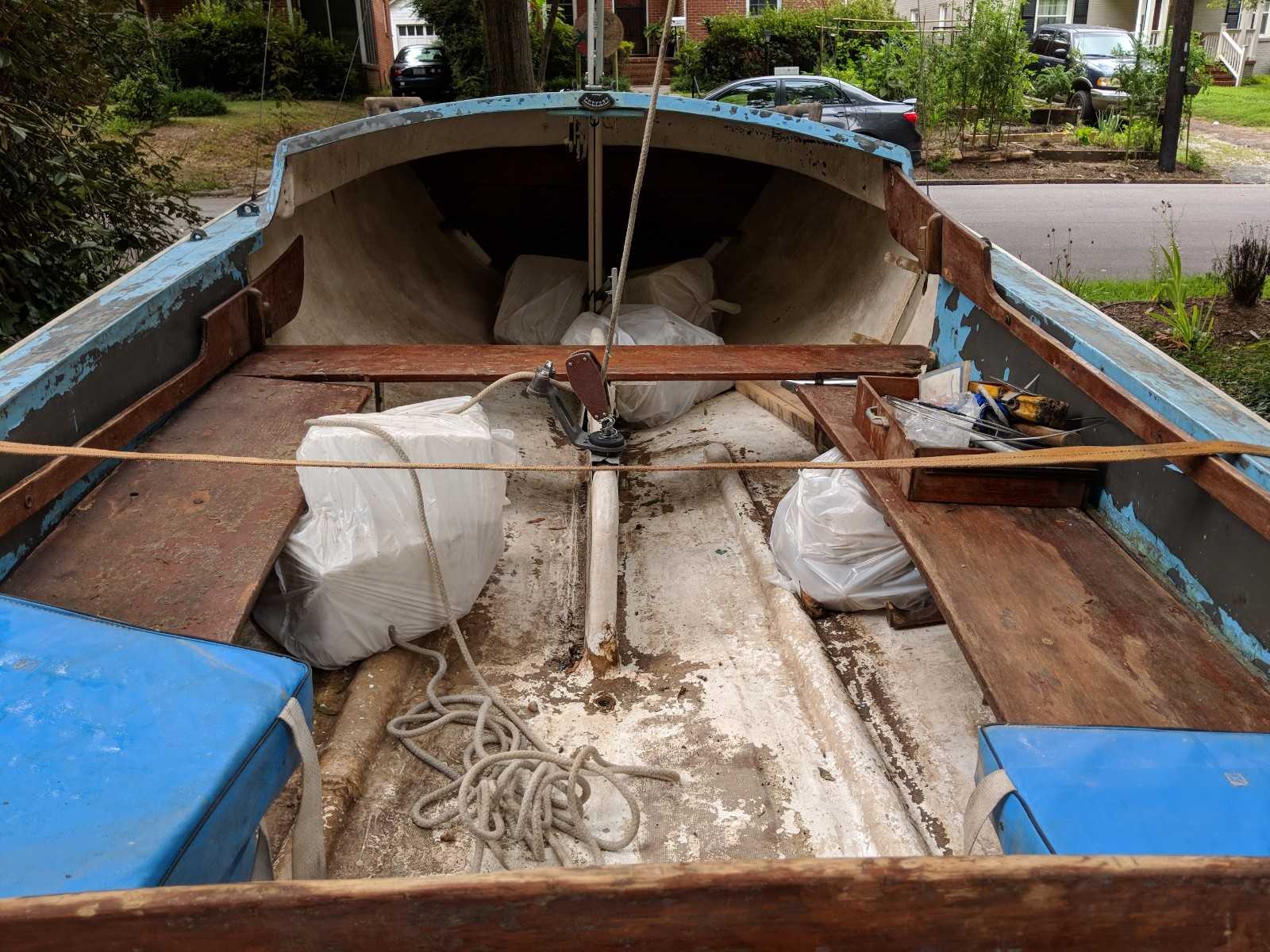

From Aft
This is the overall layout. Note that my seat boards are also quite rotted, I propped them up with bags of leftover foam blocks to hold everything in place. The seat cushions are 14"x14", to give you a scale. Also note that the seat boards both curve to follow the line of the side-tanks. Lastly note that the seat boards are narrow enough to be completely outboard of the bilge re-enforcements (the dread hump running lengthwise on both sides). Just to give you a sense of the dimensions.

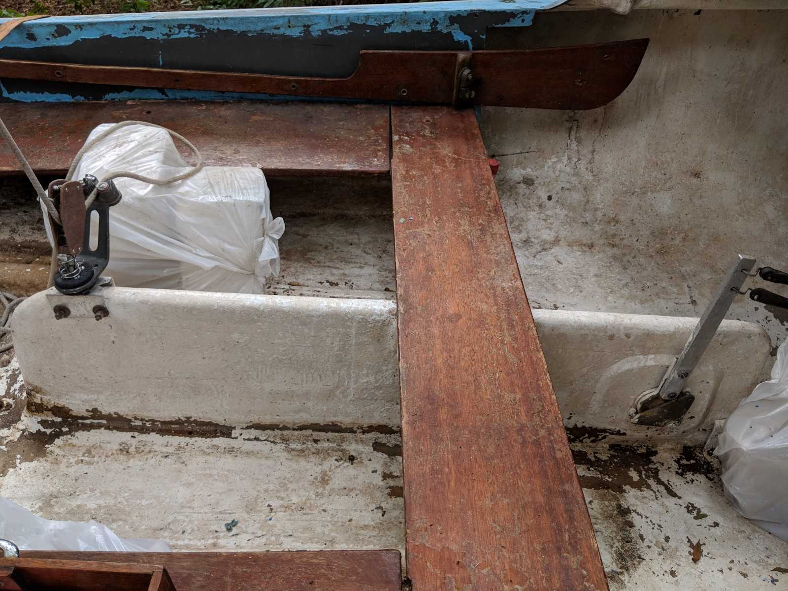

Thwart
This is the thwart setup. Note that there are angle--irons attached to the centerboard right below the thwart. The thwart is the same width as the angle-iron is long. Also this will give you your true length, from the transom bulkhead to the aft edge of the CenterBoard angle iron (line take out to the side-tanks, of course), about 60 inches.
