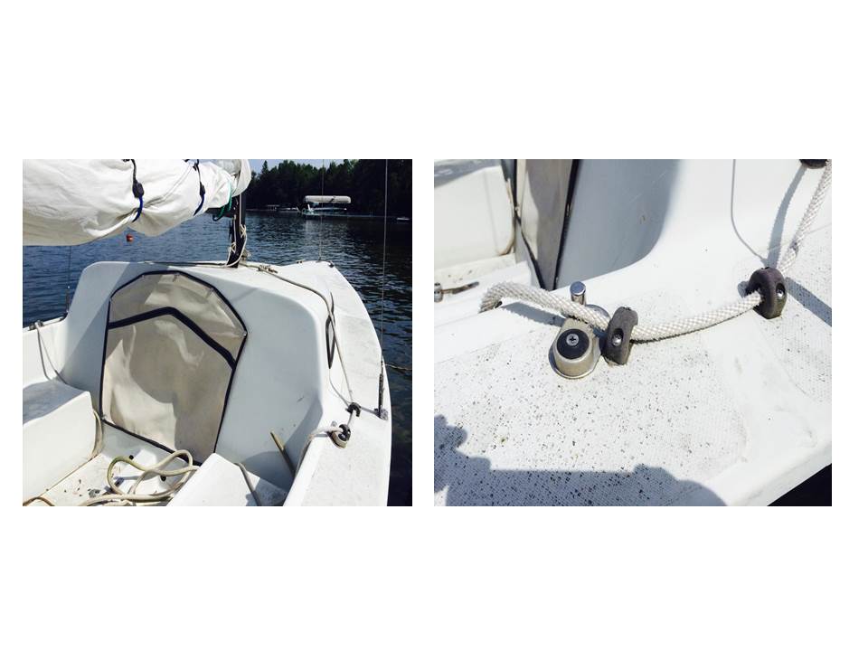

Postby bnnauti » Tue Aug 12, 2014 4:49 pm
I'll have to measure the main and downstay to verify, but the shortening could make sense. The main sail is certainly a DS sail and seems fitted well. The jib is a McKibben and seems a very good sail, but I sure feel it's a little too big. The boat was purchased with damage that had been repaired rather sloppily around the tabernacleI took it off this spring and repaired it better and found I had to slightly build-up one side of the mounting area a bit. It employs the slotted, fixed bracket the pin across the boom base slips into when stepping the mast. Not sure I can tell there was any shortening or damage there. The jib halyard certainly pulls the sheet all the way up to the top of the front shroud stay.
The sailor I was with Friday confirmed the jib is pulled in too close to center with the swivel cam cleats (I showed these in the other post on various DS's like mine). He sent images of his set-up that make more sense to me as I could not even think of handling the jib sheet mounted on top of the cuddy as mine is. I'm including images of his....a similar boat.
jib cleat.jpg (51.76 KiB) Viewed 15116 times
I don't know if I should remove the cuddy deck mounted swivels, but I can't think they would be used for halyards or anythink else. But attempting to tighten the jib to these current positions seem to bring it into the centerline too much?
Robert

Postby GreenLake » Tue Aug 12, 2014 5:59 pm
Robert,
here are pictures of my setup, just to give you an idea.
946823
The first picture shows the jib track at the side of the cockpit. In lighter winds, one would move the car back. You can also see the Barber hauler (white), although it's kind of difficult to see that it ends in a block through which is lead the jibsheet (green).
The second picture shows how the barber haulers are cleated. There are two such cleats, and what is not shown is that the two lines cross: doing this moves each cleat closer to the upwind position where it's easier to reach. Some people use V cleats mounted on the cuddy top so that the tails of the line run towards the windward side, something to consider if you have a "lip" at your cuddy edge (I don't, it's flat, so anything I let lie on top will fall down anyway, so mine are rigged to be pulled down). By pulling down on the tails, the barber haulers move the jib sheet in (it's like having a track that's mounted sideways). When pointing high with moderately strong winds (say 8-11 knots) the maximum these should be pulled in is to 18" from the center line. In low winds (<5) and downwind, they are let out fully. In light, but not very light winds, and as the wind gets heavier, you would let them out partially.
18181034
The third picture shows the upgrade of the jib car to a ratchet block (Ronstan Orbit 55mm) which makes it easier to hold the sheet when under load.
The fourth picture shows the jib sheets cleated on the centerboard trunk. The cleats are angled a bit, so they are in line with the pull on the sheet. Some people use a bar across the cleats which makes the sheet captive. This is something I don't like - I like being able to grab the sheet close to the block and then cleat it, rather than always having to pull from the windward side only.
The cuddy mounted cleats that you have could be used
