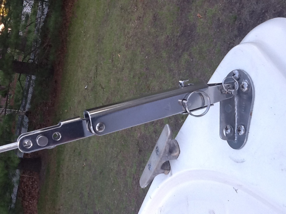

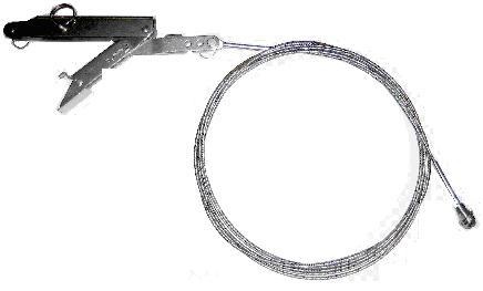

Postby Thomasjbrothersjr » Wed May 29, 2013 9:33 pm
If you are going to trailer sail it I would recommend the forestay with the quick connect lever. Works upper slick.
TBone
Quick connect on the boat

Re: replacing standing rigging
Postby seandwyer » Thu May 30, 2013 1:12 am
Yes!! I love the thought of that thing. I may buy one in a another season or two. I've been looking for just the connector piece locally and the sailing shop has no knowledge of such a contraption.
