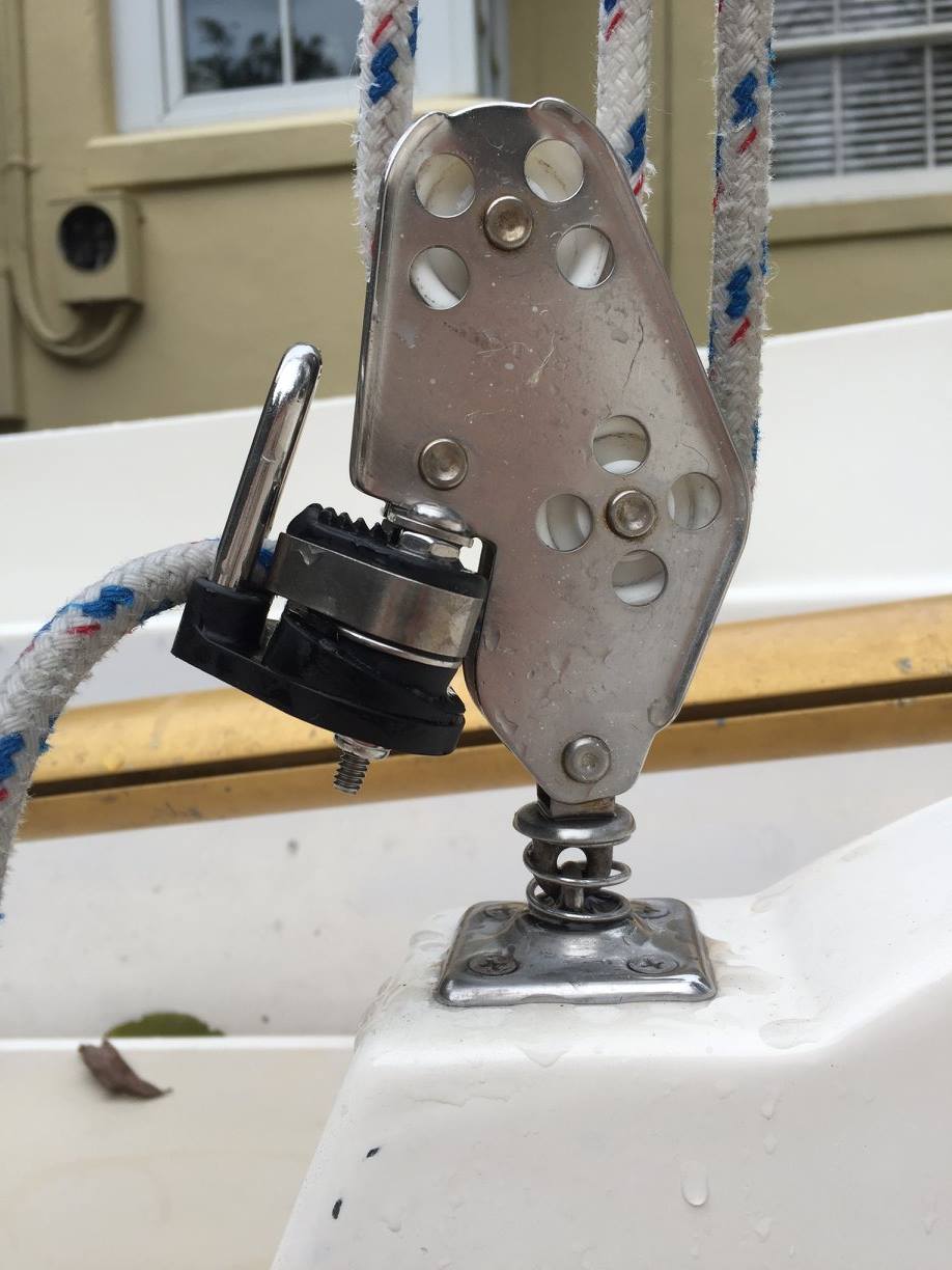

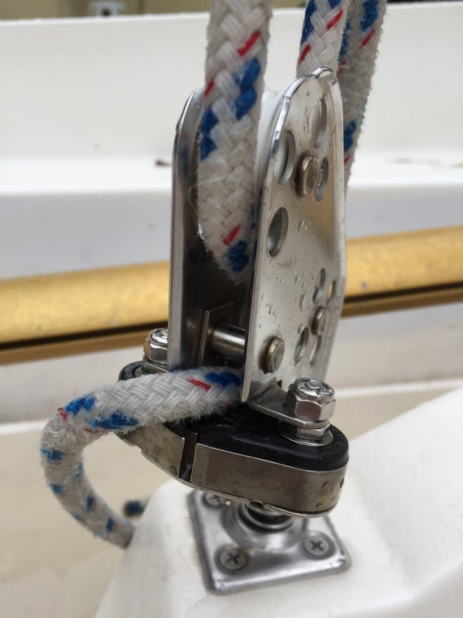

Postby DigitalMechanic » Sun Nov 08, 2015 4:29 pm
So I was able to flip the cam cleat. Here are some pics. I think I will need to add a fairlead in front, as it appears that the sheet gets stuck (and will chafe) in the little gap between the bottom corners of the block but on top of the cleat.

Postby DigitalMechanic » Sun Nov 08, 2015 6:34 pm
I am just worried about trying to mate up a fairlead to the back of the cleat. Without, the sheet can get pinched in the corner at the top of the cleat between it and the fiddle block. The fairlead will keep the line from ever getting in that corner. If you look at the bottom picture I posted, there is a nut used as a spacer to allow the clearance of the top of the teeth of the cleat. That is what creates the opportunity for the mainsheet to get int there. If nothing else it will cause chafe on the sheet. Worst case it will jam when easing the sheet. The problem would be easy to solve if the fairlead needed to go on the side of the cleat that one is typically placed, however in this case it is backwards. So, I will have to find something that comes out an inch or so from the cleat. Looking but have not found anything yet.

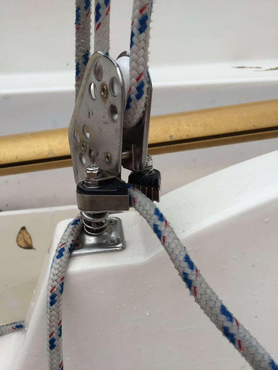

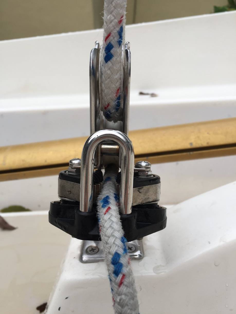

Postby DigitalMechanic » Mon Nov 09, 2015 5:53 pm
Greenlake, you are creative :D
So, this is what I came up with...

Postby DigitalMechanic » Mon Nov 09, 2015 9:09 pm
It certainly feels like it will from a dry test. I will take it out on the water for the real test this weekend. Thanks again for all the help. This ended up being a $20 project vs $200 project if it all works out as expected. I also ordered the 55mm Harken "Ratchomatic" #2626 for the boom (staying at 3:1 for now). I will report back on the performance of everything once tested.

Postby DigitalMechanic » Tue Nov 10, 2015 9:29 am
Thanks John! In case ordering offline...
Parts List:
Harken X-Treme Angle Fairlead (#375) - http://www.harken.com/productdetail.aspx?sku=375
Ronstan Medium Wedge Kit (#RF5412) - http://www.ronstan.com/marine/product.asp?ProdNo=RF5412
Just flip and use both wedges to make it flat again. This lifts the existing Stainless Steel cleat high enough the clear the raised part of the fairlead's plastic bottom.
I believe size #10 Stainless Steel bolts and nuts (2 regular nuts for the spacers and 2 lock nuts on the bottom of everything) was what fit through the cleat.
While I had it apart, I also put a wire brush on the drill and knocked any surface rust off. The PO used non-marine SS hardware, so it had leaked its rust onto the surrounding surface of the fiddle block and cleat.
