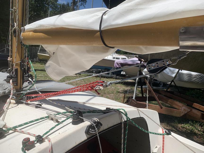

Ok, so here are the pictures I took. The boom is sitting low because the sail is down, so the vang angle might look a little strange. But when the sail is up, all the angles work themselves out.
Here is an overview of the vang itself (topside). 5:1 w/ cascade (10:1 total, plus a very long tail)

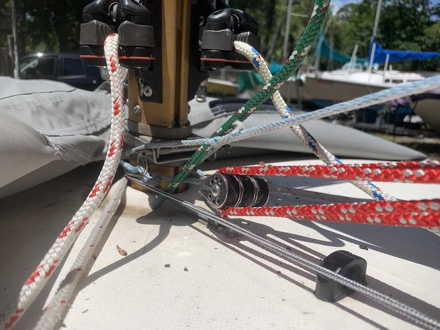

Postby DigitalMechanic » Mon Apr 29, 2019 10:19 am

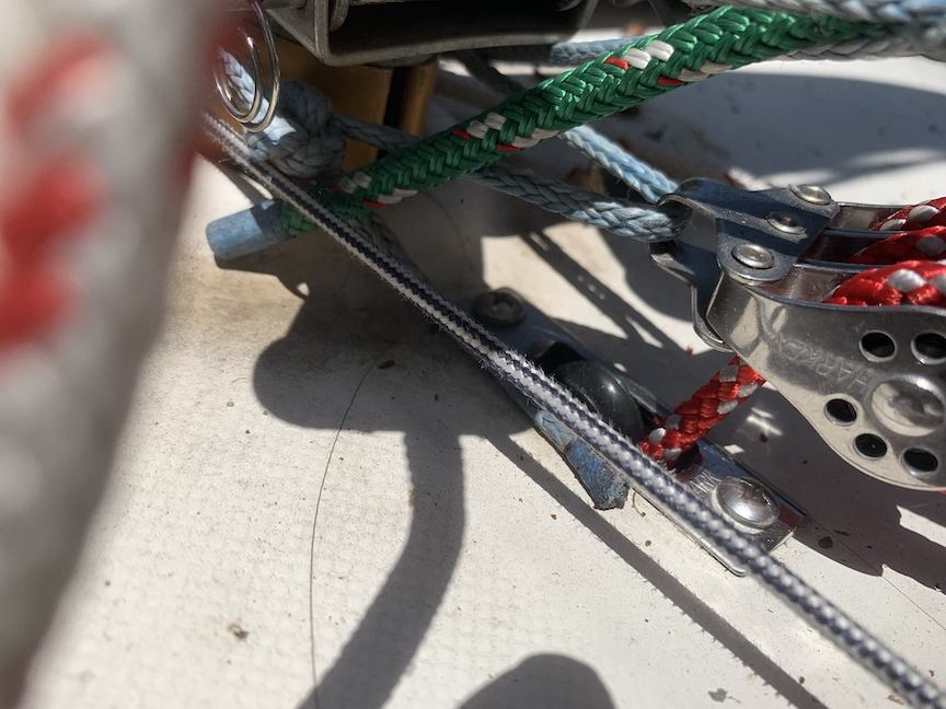

Follow the red line. Here is the through deck block... Entry point of vang into cuddy
Sorry, it is kind of hard to see the through deck block because the black and white line is covering it up a little bit in this shot.

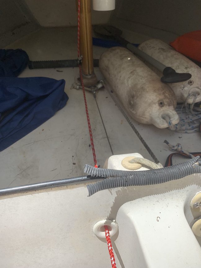

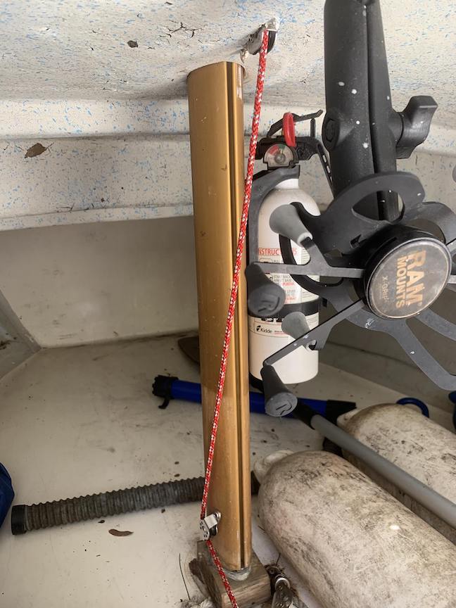

Postby DigitalMechanic » Mon Apr 29, 2019 10:24 am
Here is a shot inside the cuddy. Follow the red line from the through deck block to the cheek block on the lower mast section. It will turn off that to exit the cuddy.

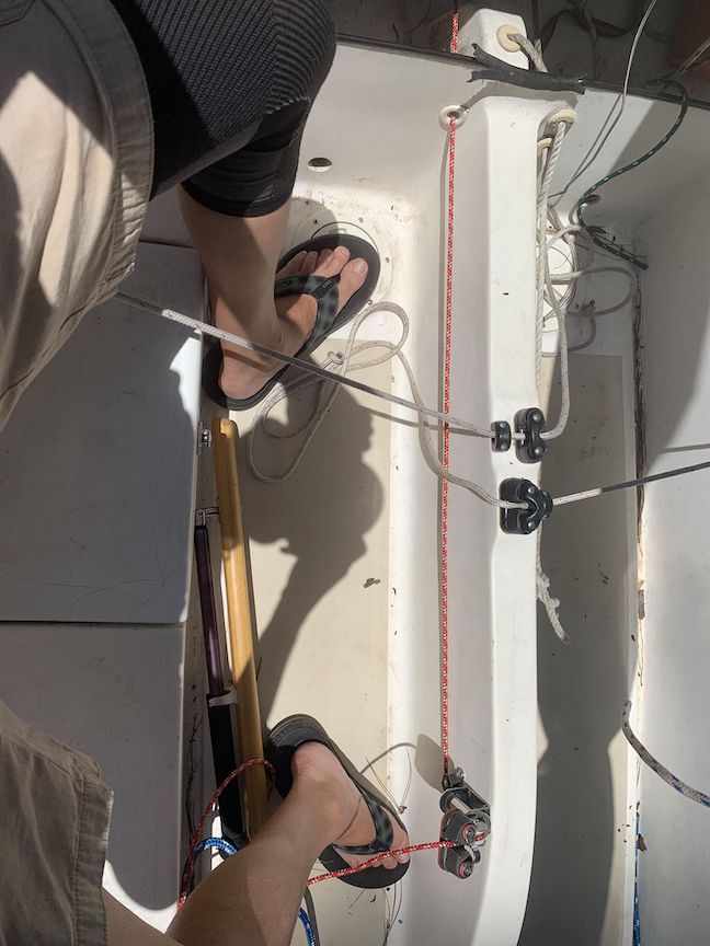

Here is a shot from above of the line coming over to the tube cleat...
DigitalMechanic

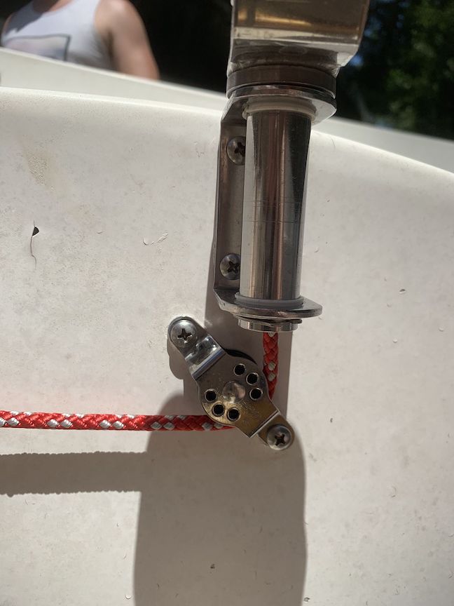

Postby DigitalMechanic » Mon Apr 29, 2019 10:32 am
The line will hit a cheek block right under the tube cleat so it can be turned to go up and through the tube...

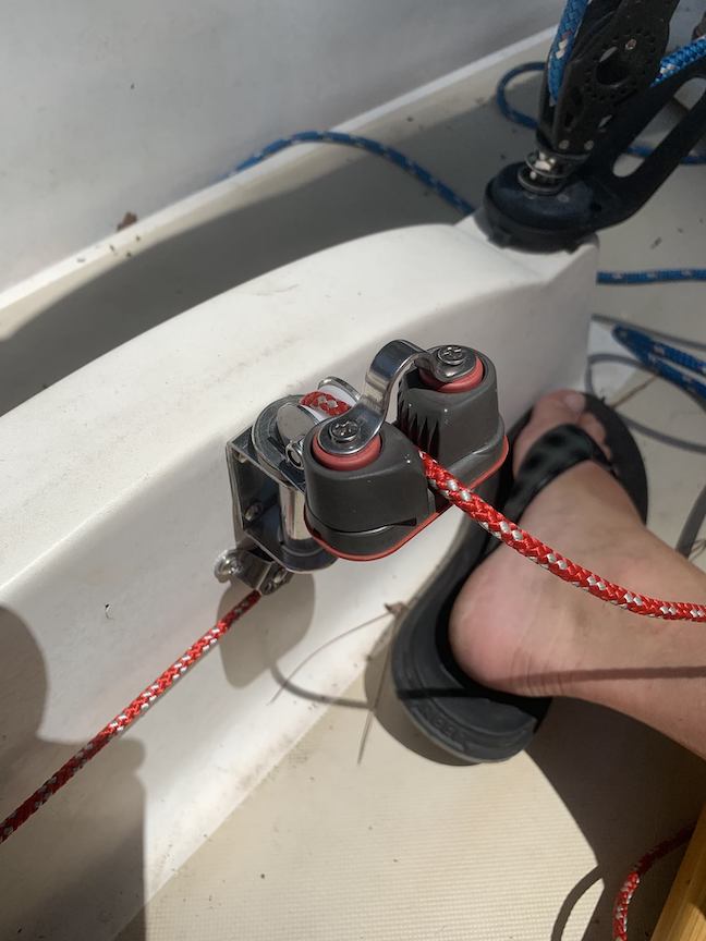

Postby DigitalMechanic » Mon Apr 29, 2019 10:35 am
And viola... through the tube and over the the last block at the top of the tube and into the cleat...
Will rotate to face either side of the boat you are sitting on. Can keep the vang in your lap :D
Vang on!
