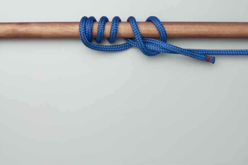

Tried the icicle hitch? Not that much harder to tie than a rolling hitch and reputed to hold on an icicle (including the taper).
I checked it out and it holds well in Amsteel.
The wraps are away from the load and the way the knot is finished off keeps it together better, so that it doesn't come apart if unloaded. Check out the link for the tying instruction. Here's an image of the finished knot.
There seem to be some variations in tying this, for example these images result in a slightly different knot.

Thanks GL. Ummmmm, what direction is the pull from(l or r)?
Re: Topping Lift / New Sail / Boom placement
Postby GreenLake » Mon Jul 29, 2013 11:58 am
Pull is away from the wrapping turns, which is opposite the way a rolling hitch would work. (In the pictures, the hitch is shown with a pull to the right.
The holding principle (if that is a term :? ) of the hitch is the same as for a splice in braided line: the "Chines finger trap". As you pull away from the hitch the wraps separate and that stretches the line, causing it to grip harder. In a rolling hitch, there seems to be a different principle, something like "jamming" the wraps together which increases the pressure for them to grip. That principle seems to depend on there being more friction than Dyneema (or icicles) provide.
Anyhow, that's how I explain this to myself.

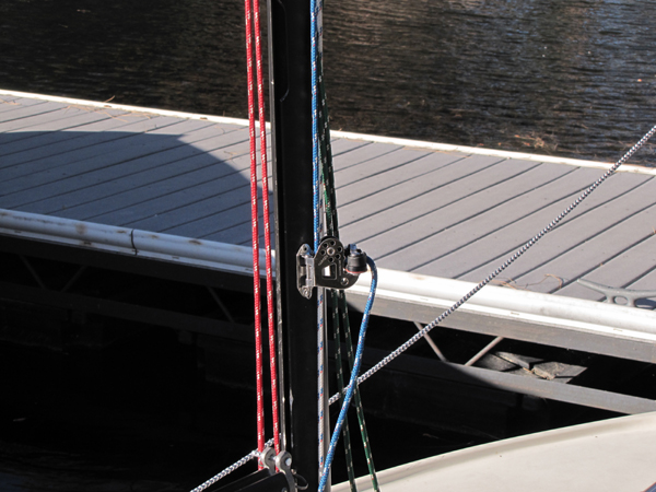

I used my topping lift quite a bit this week. It's Talbot-style - it runs from the aft end of the boom, over a cheek block at the top of the mast, to a small swivel block/cleat on the mast. I'm glad I set it up this way, even if it does mean one extra line at the base of the mast, because I almost always found myself standing in the cockpit fiddling with other things on the mast when I needed to change the topping lift adjustment.

can't argue with success
