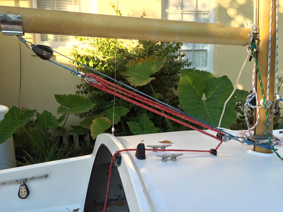

I am with you. I already copied you for the most part. Instead of leading the vang all the way to the back of the cockpit, I just put a little fairlead between the existing horn cleats for the halyards, and then ran the vang to a cam cleat on a a riser at the cuddy's edge and let it drape over the opening.

Just went out and grabbed a picture. Here is what I did with mine. It is similar, but does not come back to the cockpit like yours. I bet it is nice to have it conveniently located in the center of the boat.
I think that I might not have the best fairlead placement on mine. The angle may be kind of sharp. I may have to either work on pulling it down closer to the cuddy top, or move that fairlead back a bit.

DigitalMechanic wrote:I think that I might not have the best fairlead placement on mine. The angle may be kind of sharp. I may have to either work on pulling it down closer to the cuddy top, or move that fairlead back a bit.
If you replace the fairlead with a block and move it forward, closer to the mast, you can then then turn around your purchase and have it "rigged to advantage". Or move it back, as you suggest. As it is placed, it will pull the base of the vang to the centerline of the boat and that's not what you want.
