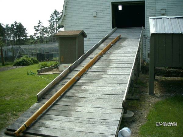

I have a Sailstar Explorer 17, which is very similar to an O'Day Daysailer. I have available to me a 30' older wood mast, they think it is from a C Scow. I need a 23' mast. Any thoughts on whether I can make this work, with a bit of work!? I have all the rigging for my old mast to transfer. My biggest concern is the possible weight difference in the mast?
