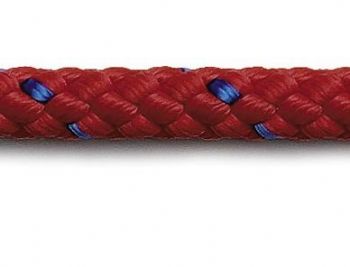

Now, there's only one line left on the boat: the painter.
I've been using 3/8" solid braid, polypropylene from the feel of it, but I can't find it again online right now, so no picture. Orange with black tracers. No core, but solid braid, so it stays round. It floats, and it's easy to tie knots in it that hold, because it's soft, but has good friction.
Closest I could find is FSE Robline's Albatros
That's definitely the same braiding pattern, but not the colors I have, so it must be some competitor's product.
