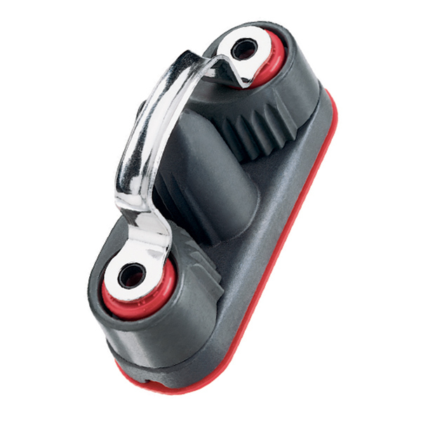

I was wondering if the jib sheets could be run aft to a single cam cleat mounted on the centerboard housing just forward of the main sheet block? That would put the jib sheets in easy reach of the helmsman when soloing, but would not be in the way if you had a crew member to trim the jib from the default location.
Would a single open cam cleat suffice? Or would a double cam like this one work better?

Postby GreenLake » Sat Feb 09, 2019 1:37 am
In the double cleat you show, both lines have to be lead in the same direction, that is they would face aft.
That means, crew in the normal seating position cannot operate the jib sheet.
So I am not sure what you are trying to accomplish. In my experience, single-handing the DS with the standard CB location of the jib cleats
1034
isn't a problem. In low wind, cleat location isn't critical, but in higher winds you want to sit out (or even hike) and then pulling aft would seem not much of an advantage, because from where you sit you wouldn't be able to pull aft.
What the double cleat might work for is spinnaker sheets.
