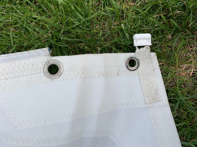

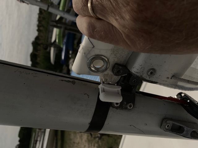

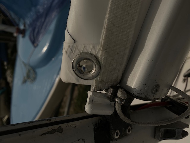

Have attached a couple of pictures showing how the foot of the sail sits too high in the boom track to allow me to insert the connector pin through the grommet, and the work around I am using by inserting the connector pin behind the "plastic car/guide" sewn on the sail below the grommet. There is no place for the car to go, but the connector pin does fit behind it / tack seems secure. Not sure if this set up is sub-optimal and a cause of boom not staying on the gooseneck pin, even if I really pull out the outhaul.

Not quite able to see this from your pictures, but something is holding the sail in the boom track, correct? Bolt rope? Not sure that is up to the task of holding the tack down. You may need to use a lashing thorough the lower of the two grommets and around the boom to take the luff tension (until you apply the Cunningham, that is). Some thin stuff, wrapped a few times and tied off with a square knot. You don't need that super tight, just so it takes load when tension goes on the sail.
The slider car you show in the pictures is intended to take the fore/aft tension at the foot of the sail; it has to be in the mast track for that, of course. If you tighten your outhaul, even moderately, the boom should not be able to move backwards; but that only works if the front of the sail is held close to the mast by the slider.
Tightening a vang will help as well, but there are conditions where you want either control somewhat loose. If you experienced the boom escaping in stronger winds, that's when you would most likely have both outhaul and vang tight.
What kind of vang do you have? is it a high purchase one (better than 10:1?) In that case, the PO sailed his boat using vang sheeting, where the vang is tight even upwind. The good news is that the type of gooseneck you show is really sturdy and probably well suited to vang sheeting. If your vang isn't set up for that, you may be able to upgrade.
There's some discussion of vang sheeting on the forum, you may need to use an external search engine to locate it (look in the how to section of the forum for hints on how to do that). But if you have questions after that, feel free to ask.

Yes foot of the main sail has bolt rope that fits in a slot on the boom. I think the tie tack down through the cringle is a good idea. And why not also just add the pin behind the plastic car like I have been doing also ? The car would have gone into the feeder slot which is now u under the goose neck... the main sheet halyard exits out of the feeder slot. I had posted pictures of that on my halyard questions post.
There is no current Cunningham set up that I can see at this time and think that I’ll address that after I’ve got the gooseneck / boom attachment issue resolved.
The boom vang has a multiple pulley set up, and I’m thinking four on each side... not positive though and not sure on mechanical advantage ratio... will check it out tomorrow / take a picture. I did use the google search option for the site on Vang sheeting. Thanks for that, a fair number of posts (wish there were more pictures), and still going through that. Seems like tight is better on this set up/which is the same as folks at the club say there DS I are set up.
Going to sail tomorrow, should be light wind, going to crank down the Vang tight right from the start, lash the main tack to the boom, pull out on the outhaul and see if I can pull the boom out from the gooseneck. See what happens, go sailing :)
