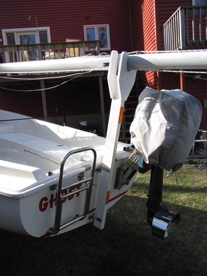

I have a four HP motor on my Mariner and after dinging my new rudder with the prop, I attached a guard around the prop. (see attached) It is made to improve the efficiency of the motor, but works great as a guard.

rnlivingston, where did you get the neat guard?

Thanks all. Now I know where I saw the peg thing. Roger's book! I just found prop guard on westmarine site. Search prop saver. Will research further to see what's involved with installation.
