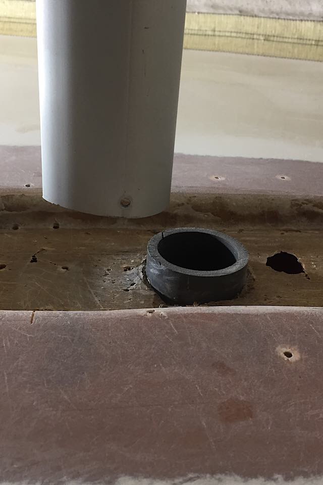

Postby dpatrick » Sun Aug 19, 2018 5:27 pm
I’m back!
After all the work I’ve done, my new bottom plate of the mast hinge is badly deformed again.
It is bent down towards the cabin top, just like the last one. My rig is tensioned pretty tight but I don’t believe it’s too high.
The boat sails great and I feel if I loosen the rig any it will be sloppy. Could it be the mast hinge is just a bad idea and too thin to take the load?

Postby GreenLake » Mon Aug 20, 2018 6:14 am
The tabernacle should not be supporting the main compression load. That load should be supported by the compression post. Where the tabernacle intervenes, the load needs to be transmitted by parts resting flat on top of each other with no give. Looks like in your case there's something off in the geometry and an unsupported piece of the tabernacle gets loaded (and therefore bends - probably just enough to let other parts make contact and take the load as designed).
My thinking would be that as long as you can still raise the mast, you might not need to do anything.
On your photo it looks like the tabernacle is wider than the compression post, which would mean that the overhang of bottom plate needs to hold the entire load - can't imagine that it's strong enough for that. (But, disclaimer, I don't have one of those in my mast, so I don't have practical experience).

Postby dpatrick » Mon Aug 20, 2018 7:55 pm
I think you nailed it. It just can’t possibly take the load. I bought the boat with this installed already so maybe it isn’t even the right application for this hinge plate. Seems it would work good on a deck stepped system (as in bolted to the deck) but it sure doesn’t cut the mustard in this scenario. I may try and make a solid filler piece to insert in between the plates.
But like you said I may just keep sailing it the way it is.
