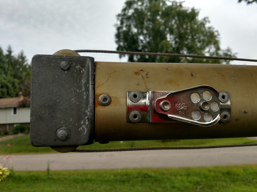

Hello Everyone - I'm new to sailing and picked up a '78 Day Sailer II last year. While hoisting the sails in my yard I noticed that the main sail did not go up to the top of the mast - see first photo. I saw that the line was through the pulley on the side of the mast, and then a friend said that it should be through the top of the mast, so I changed it - see photo two. My questions to the group:
1. Which location is correct - top or side?
2. If the correct location is the top, then what is the purpose of the side pulley?
3. If the correct location is the side, then what is the purpose of the top pulleys?
Nick
Original halyard position - side pulley
Changed position to top pulleys. Which is correct?

TOP!
The side block was probably installed for a topping lift for the end of your boom.

hsumralljr is correct. The main halyard goes through the top pulley (the fitting is called the masthead, and the wheels are called sheaves).
I agree about the side pulley (called a block) being used for a topping lift. I've got a similar setup on my 1980 DSII.

Nick, looks like you got two good answers here.
Just to add: a topping lift is a (thin) line that can be used to keep your boom level when the sail is down. You can use it with a boom tent (as some people to do camp in the boat or cover it when in the water) or you can flake your main (or roll it) and tie it to the boom while docked or at anchor, to keep it out of the cockpit.
The topping lift should be slack while sailing.
