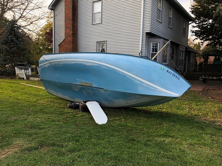

Following the advice on this forum, I was able to get her off the trailer and careened in my back yard. It seemed no matter how many times I tried, the downhaul would derail every single time I pulled on it. Keeping tension on both up and downhaul lines didn't make any difference. In the end I decided to remove the CB to get a better look. Accessing the bolt through the inspection ports and removing the CB was a breeze. Getting it back in should be more fun.

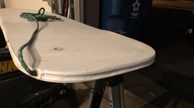

After inspecting the CB I noticed right away that the "top" of my CB that the downhaul wraps around is not level but actually tilts to the side. This appears to be a defect in the molding but definitely encourages the downhaul to pull to one side under tension.
View of the "top" of the CB - uphaul line is supposed to wrap along this edge when CB is up

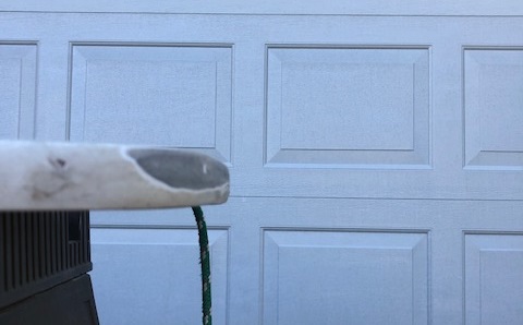

In the end I decided to grind the leading edge level and carve slot into the CB. By carving directly into the CB, I wouldn't have to worry about adhering more material. I was also a little worried about clearance inside the trunk.
I started with an electric palm sander and an 80 grit sanding disk. The sander chewed through the gel coat and poly really quickly. The edge was level in only a few short passes.
CB edge sanded level (approximately)

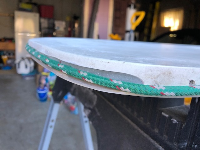

Now that the board was level, it was time to cut the groove. I used my dremel with a 3/8 sanding head attached. Then using the downhaul line as a guide, masking tape was used to mark the channel. My goal was to run the channel across most of the top of the CB from the uphaul tang down to the downhaul attachment point. This was the primary area where the downhaul was derailing.
Marking the groove to be cut
I cut the channel free hand using the tape and my eye as a guide. The channel was about 3/32" deep which seemed sufficient for the downhaul to have a seat. Was afraid that going deeper and putting too much stress on the CB edge.
Test fitting the downhaul
