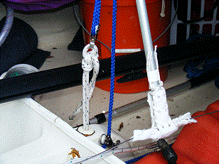

Postby TIM WEBB » Thu Aug 04, 2016 7:38 pm
I would change it if I were you. The Red Witch ('79) came with the DH block arrangement attached to the inside cuddy lip. The CB is not ballasted, and if the boat is moving when trying to lower it, the force of the water against the CB can make it tough to lower unless going downwind. I put a snap shackle there for quick release when CB is up, to make cuddy access easier. I understand some earlier/later boats do/did not have that arrangement. Some folks (including me) have tried bungees or springs on the DH, with varying degrees of success. In the end I opted to go for an autorelease clam cleat on the side of the CB trunk:
1570 1568 929
I used one for the rudder DH as well:
926
