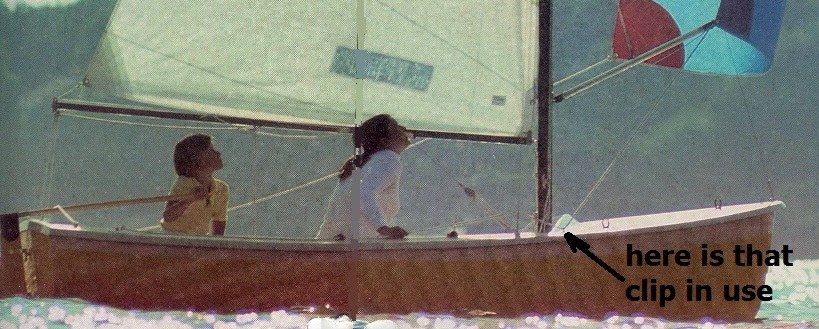

Clip In use on a Widgeon, basic use is same on a Day Sailer
Widgeon_spinnaker_clip use.jpg (136.13 KiB) Viewed 14113 times
windwalker wrote:Also what are these for? Just forward of the chainplates, the black part is rubber.
Those are used when flying a spinnaker, I was never sure exactly how to use them on my Widgeon, so someone with more spinnaker experience than I is welcome to correct me as to which line goes through them and the correct terminology of the guy vs sheet. Anyway, I would clip the guy line (line that controlled corner (tack?) of spinnaker running through pole end) through the clip like this on that side and let other side (clew?) just run from spinnaker aft to the block near the stern and forward to the cleat on that side. When I jibed the spinnaker the setup reversed.
I can fly a spinnaker OK, but never really have learned the correct terms for all the spinnaker rigging (despite over 40years of sailing experience, 9 years with a spinnaker!) I don't have one on my DS II, I sail either alone or with my 79 year-old Dad, so spinnaker handling would be dicey on my DS II. The Widgeon was small enough that I could set and douse the chute solo (being younger in those days helped, I was 24 when I bought the Widgeon, 32 when I sold her).
Anyway, I hope I cleared up what those fittings are for, even if my spinnaker terminology may be off. I'll attach a picture of a Widgeon under spinnaker (not mine) that sort-of shows how those clips are used, and it does seem to show that I set my spinnaker correct, whether I have the terms correct or not, at least I did set it correctly.

I think the clip doohickey is called a "Twinger." And yes, it is used to keep the spinnaker guy angling down instead of aft. On an Olson 25 I crew on, both spinnaker sheets run through twingers, but the twingers are blocks attached to leads. Like Barber leads, but fore and aft, instead of athwartship. Necessary on a 25' boat because the crew can't reach that far forward from the cockpit.
