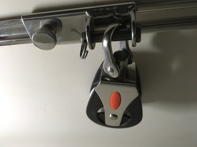

Greenlake, agree completely. I'm wondering if I could accomplish the same thing more easily.
I'd value hearing folks' opinions/feedback if I simply replaced the existing block with a new ratchet block, but I retained the existing jib track? As you can see in the photo, I have every reason to believe my jib track is OEM to the boat, circa 1970. There's nothing wrong with it and it appears that it could be retrofitted with a new ratchet.
Benefits to doing this...
1) avoid cutting access ports on each side
2) would avoid the costs of replacing the jib track
3) avoids the effort to make a clean installation.
Any cons?
2629

Postby GreenLake » Mon Mar 04, 2019 10:26 pm
If you can indeed replace the block on the existing cars, I see no reason why you would need to upgrade the tracks.
The key will be whether you can free the "U" that's mounted to the slide. Better not plan on inserting shackles or other extraneous parts - you'll want to recreate the approximate geometry you have now.

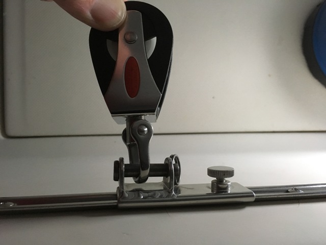

Postby Woreign » Mon Mar 04, 2019 11:37 pm
I haven't taken a photo yet, but I replaced the stock donut-hole and cleat with a swivel pulley. It attached easily to the piece that slides on the track with the stock pin.
I also like how the pulley lays flat against the side of the cockpit, making it less painful if a crew member happens to lean against it.

Postby SpeckledTrout » Tue Mar 05, 2019 8:57 pm
Woreign, I'd value seeing the photo of how you configured that to work.
I'm planning to get the same ratchet block (Ronstan 55) that Greenlake recommended. I checked its dimensions and that block is ~0.5in longer than my current OEM block so I want to minimize what I use to attach it to the jib track fitting.

Postby Woreign » Tue Mar 05, 2019 9:37 pm
Here you go!

Postby SpeckledTrout » Sun Mar 31, 2019 8:44 am
Folks, much thanks for your feedback/suggestions on this thread. I replaced the jib blocks w/ Ronstan Ratchet 55 blocks per Green Lake's suggestion and they fit great. I used Woriegn's suggestion to simply affix those to the existing OEM jib track and it worked well. And, I followed several suggestions to replace the OEM cam cleats with Ronstan 'Medium' ones. Now, it's time to go sailing.
