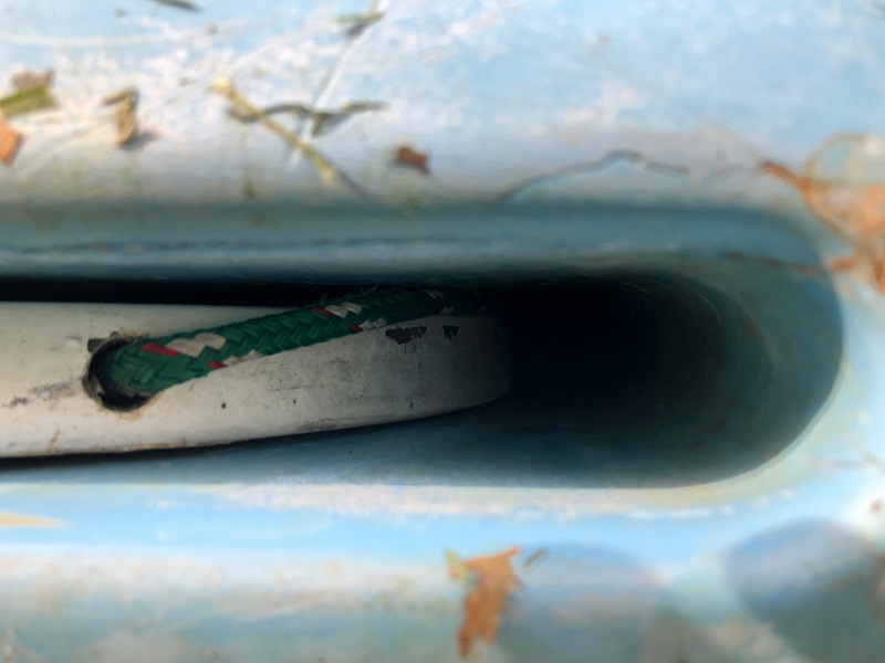

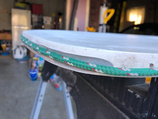

Postby GreenLake » Sat Jul 04, 2020 9:19 pm
The green line in these pictures should be where your black line attaches. Note how it wedges itself. The owner of this boat has modified the top of his CB to provide a positive channel in which the downhaul is guided. Depending on whether a wedged downhaul is or isn't a concern for you, this modification may be useful.
Details here.
