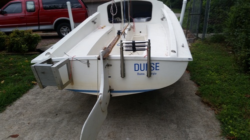

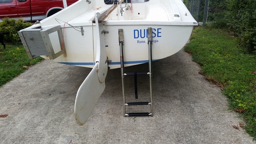

Postby jsbowman6 » Mon Aug 15, 2016 3:16 pm
Thanks jeadstx! This upgrade was easy. Hardest part was finding some deep throat clamps to hold the ladder while I checked that the rudder could swing fully, the top step was low enough for your foot to fit under the stern, but high enough so I didn't have to use an inspection port for the bolts. And again thanks jeadstx for making me aware of getting as close to centerline of the boat as possible so the boat would not be so tippey while using the ladder.

Re: Swim Ladder?
Postby jeadstx » Tue Aug 16, 2016 1:16 am
You're welcome.
