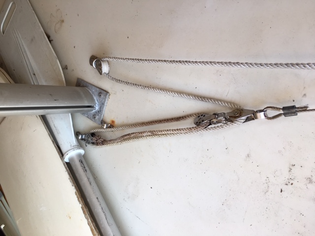

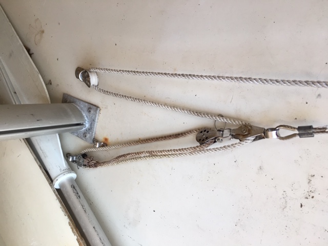

Postby jimfrens » Mon Sep 30, 2019 6:19 pm
photos of my uphaul rigging:

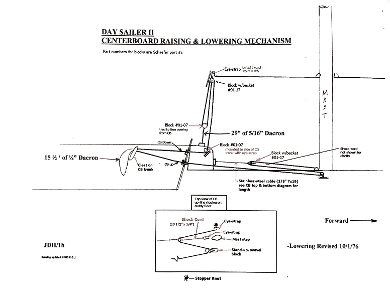

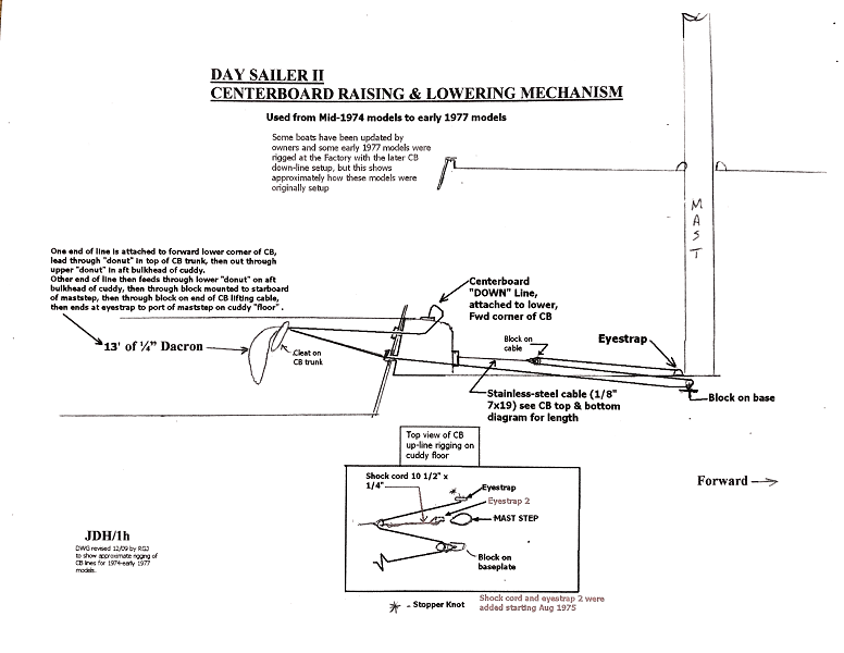

Postby Nephroid » Mon Sep 30, 2019 11:41 pm
Congrats on your purchase! I just bought my '72 DSII a couple months ago. Just did my first "shakedown" cruise last weekend. Write-up forthcoming but I too had some issues w/ my CB.
In my case, my downhaul was "off track" and got jammed between the CB and the trunk, locking them both in place. Ultimately I decided to take a swim and manually pulled the CB down from underneath. Once down I was able to pull the board down and didn't have any issues the rest of the day. Despite this after getting her back on the trailer I looked underneath and once again the downhaul seemed jammed against the trunk. Curious to see what happens the next time I go out.
I got the below pages courtesy of Rudy at D&R Marine. I mentioned the issue when I was ordering new standing and running rigging.
Not sure if yours is configured the same way but thought I would share in case they're helpful.

Postby jimfrens » Wed Oct 02, 2019 10:46 am
more photos of uphaul rig:

Jim, I see your uphaul has an added block to double the advantage. The standard set-up is more or less just a turning block with a shock cord attached to keep tension on the uphaul cable. I like your set-up and going to have to try it. Thanks for posting the picture! JOHN
