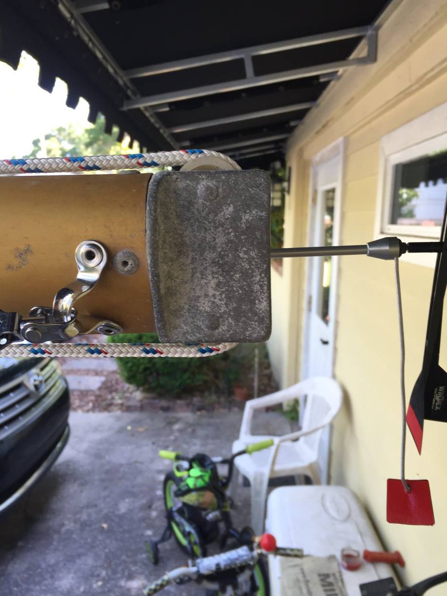

DM, about your mast. Good thing would be to make sure of the profile and dimensions, and anything else. A good photo of the masthead might help someone recognize it. On mine, the pins were aluminum and flush with the surface. I had to drill them out. Replaced them with SS clevis pins. I

Yep. This is a problem I created for myself when I upgraded the boom vang. I think I have shown pictures of it before, but I needed to really pull the part of the vang that connects to mast down really low, so the angle would work with my fairlead/cleat on top of the cuddy. Of course, once I got to the point where I got the vang sorted, it leads to another project... you know how it goes ;)
About the sheeves in the mast head... I can actually see where the center of the sheeves are located. I could probably drill that out. What sheeves do you recommend replacing them with?

Masthead sheaves in your picture: just drill those out and replace with same size SS clevis pins. (Just measure the hole and purchase based on that). If you are worried about dissimilar metals touching, use TefGel to isolate. Cleving pins have a hole on the end. You can use cotter pins, cotter rings or whatever. I found that whatever length was just long enough didn't quite fit all the way (exposed only 3/4 of the hole). So I ended up not using cotter pins or rings, but SS seizing wire. At least at the top of the mast you don't have to worry about an errant sheet snatching off the wire.
