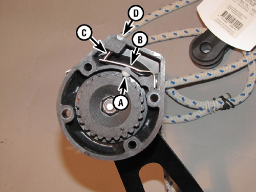

I am curious about one of its features, though: "Adjustable ratchet system prevents the arm from falling to leeward." How precisely is that supposed to work? Presumably, the ball bearings in the base cut friction to the extent that the swivel arm could move in response to gravity and not just pull. Still can't figure out how they work a ratchet, when you need to pull the arm to the other side on the opposite tack. The '60s era fitting on my boat has enough friction that it won't "fall to leeward", so I'm good, I think.

PostPosted: Wed Oct 19, 2016 6:58 pm
by Alan
Mainsheet swivel cleat bottom view.jpg (144.91 KiB) Viewed 32120 times
Above is a bottom view of the Ronstan RF7. The ratchet consists of a cogged disc and ball (A). Tension on the ratchet is supplied by a flat spring (B) and adjusted with a screw (C). Access to the screw is through a hole in the side of the base (D).

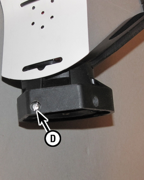

Mainsheet swivel cleat ratchet adjusting screw.jpg (166.57 KiB) Viewed 32120 times
The second photo is another view of the tension adjusting screw (D). The Ronstan website shows an Allen wrench (I have a slotted adjusting screw, not an Allen). The adjusting hole is also shown in a slightly different location in the base than what I've got.
Re: Playing the mainsheet with the stock block
PostPosted: Thu Oct 20, 2016 12:47 am
Wow. What service!
Seems weird somehow to have ball bearings to reduce friction and then to reintroduce it via this "ratchet" mechanism.
The pictures make clear that it's not a one-directional ratchet. (In fact, it appears that the term "ratchet" may not be entirely accurate if it's not one-directional, but I'm no mechanical engineer, nor do I know what alternative term would apply).

I'm not a mechanical engineer either, but it might qualify as a cam wheel, since the rotary motion of the disc causes reciprocating motion of the ball.
I finally figured out why there's a ratchet/cam wheel/noisemaker. Ronstan says this: "Adjustable ratchet system prevents the arm from falling to leeward." I tried it with a jury-rigged mainsheet, holding it up in the air and tilting it to simulate heeling. With the tension released, the swivel arm does fall to leeward if there's any slack between the mainsheet blocks while the bitter end is held loosely by the crew. The mainsheet twists as it happens. Presumably, the mainsheet crew is sitting to windward at the time. Whether that would be a nuisance, or maybe a real problem, I can't tell without installing the setup and sailing with it, which ain't gonna happen soon, unfortunately.
