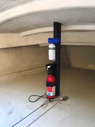

Other than just throwing in coolers and plastic bins, what type of ideas or improvements have you all made to maximize the storage space of the cuddy? I read that the DS1 had trays on either for storage, but the DS2 & 3 just have an open area. Also, would it be OK to drill holes in the cuddy roof reinforcements to add hooks or other attachment hardware? I've also been considering having some cushions made to fit the floor of the cuddy in case my family or I would like to rest inside for any reason.
I started by attaching the fire extinguisher and air horn the lower end of the mast:
