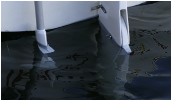

Here's a picture what it looks like at the dock.
Their normal/short shaft just about fits the cavitation plate to the waterline. Will that work in waves?
Separation from the rudder looks good.
