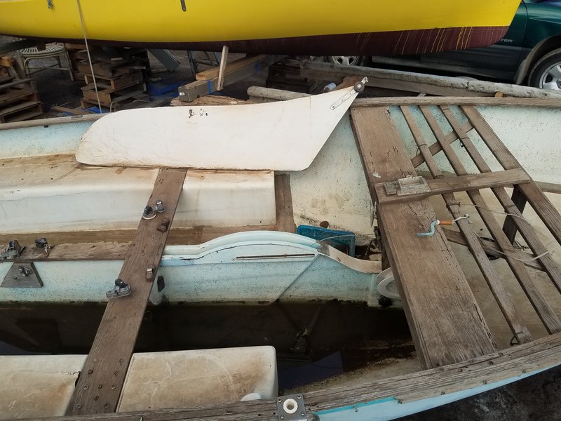

Pic below of the Thistle CB.
The Thistle CB has no pin, and no pin-hole in trunk. Instead it has rollers on the pointy end of the CB, which roll on the curved trunk top. Tackle assisted fore and aft rolling raises and lowers the board.
- rsz_thistle_cb__and_trunk.jpg (125.09 KiB) Viewed 28390 times
I like the Thistle CB system. I like its looks. I've always admired Thistles. I was about to acquire this very Thistle. That could be why I convinced myself it would be just as easy to simply transplant the entire Thistle trunk with CB into my yellow boat. No need to modify the Thistle board!! Hence the whole job would probably even be easier!!! I came to my senses, after a little while.
To make the Thistle CB fit my yellow sloop, I will cut some off that pointy end and shape that end to match my trunk. Then it will be 51" X 13.5". Close enough for me. Saint Rudy's new DS boards are 50" X 14.5" . They weigh 51-55 pounds.
This Thistle board weighs in at 73 pounds. It's heavy. It will weigh a bit less after the pointy end is trimmed. A square hole fitting for it is being fabricated in stainless steel. A square tube was welded up today. It is a snug fit on the old bronze handle's slightly worn square lug. Flanges will be welded to the square tube. Pics later. Baby zincs shall be embedded in the board near the SS.
I was going to remove and re-use the bronze square hole fitting from the old board. Then I realized that board is luckily almost perfect as it is for the new rudder needed. Less work, leaving it as is, I decided. Another reason to leave it as is is that it may yet be needed to serve as the 'dream board'.
I'm with you if you're thinking 70 pounds might be too much for the old handle to lift without hurting itself or the trunk/fittings. Rather than find out the hard way, I guess I'll have to devise a lifting system near the after end of the trunk. I'm thinking a new hole in the trunk top, some short SS tubing with a fairlead on each end, and a chain or wire rope attached to the board in some clever fashion.
Chain would be good for pinning at any board depth desired, and a pile of chain seems easier to live with than a length of wire rope, when it is all up. However wire rope could fit tightly in a small hole, piercing a sturdy rubber cap placed atop the fairlead to discourage unwanted seagushers. Since I like the chain idea, maybe I can devise a rubber seal for it too. I guess lifting will be done with a handle, rather than with tackle, until I realize/admit tackle would be smarter/better. Maybe. Not sure. I will start with just a handle on the chain or wire rope.
I suppose that once I grow weary of swimming underneath to clear seaweed from the chain so I can raise the CB, I may get around to building the aforementioned new 50 LB 'dream board' stuffed with Mr Okuda's lead slabs. For now, this Thistle CB seems to be my quickest acceptable route to sailing. It does have a foil shape, and single handing should be easier with 70 pounds down there, as long as it doesn't break something.
