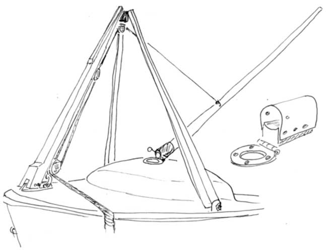

Here are a few pictures:
15451033
What you see is a circular base, a gate hinge, a wooden block and a bit of aluminum sheet metal forming a sleeve. You start with the thing folded down, insert the first 6" or so of the mast into the sleeve, hinge it into vertical position and then drop it onto the mast step. Something I can easily do single-handed. You appear to have enough clearance between deck and the lowest cleat to allow for such a contraption.
(You will also note the bent aluminum strip around the front of the disk: it's there to keep the jib sheet out.)
The place where I stashed the full write-up appears to be temporarily or perhaps permanently offline: here's at least the drawing.
The hinge is the large detail on the right. Also shown is an A-frame that can be used by anyone, no matter how short/tall, to raise a mast. (I built one and then decided to retire it until I'm old enough to need the extra support).
You may have to measure the length required for your stays. That would depend on your spreader widths and there may be the odd inch of difference between the way a mast fits your boat and how it fits a DS. I believe DR marine can make stays to order and they will be able to tell you where and how to measure.
