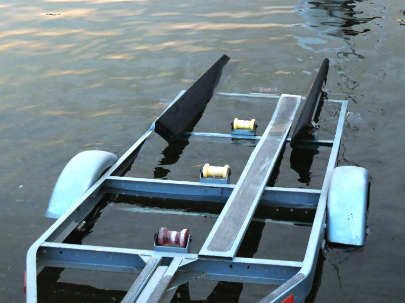

Here's a picture of the trailer ready to retrieve the boat.
Trailer ready to receive boat
You can see my trailer has the traditional center rollers with bunks. (Some people go so far as to use only bunks). I park it with the rearmost roller right at or below the water surface. I replaced the original roller with one that's a bit wider and has a shallow V shape with a central notch. I trap the bow in that notch. Then, when I pull the boat up the notch acts like a pivot, helping to align the boat.
The rearmost roller is dropped an inch or two, so after a while, the boat begins to rest mainly on the bunks (with no weight on that roller), with only the bow continuing along the rollers. One of the middle ones is positioned below the centerboard and prevents that from dropping during transport and launch. With this setup, I've not had any trouble getting the boat on the trailer straight. If for any reason it's off by a bit, I usually just lift the back and shove it over. (Even partially supporting the rear by lifting will reduce friction and allow it to slide. I don't think you actually have to lift a full half of the boat's weight.)

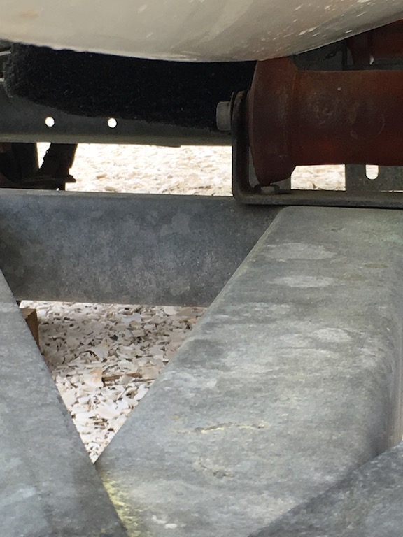

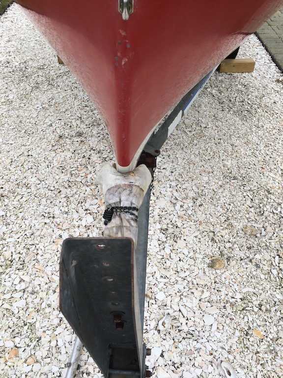

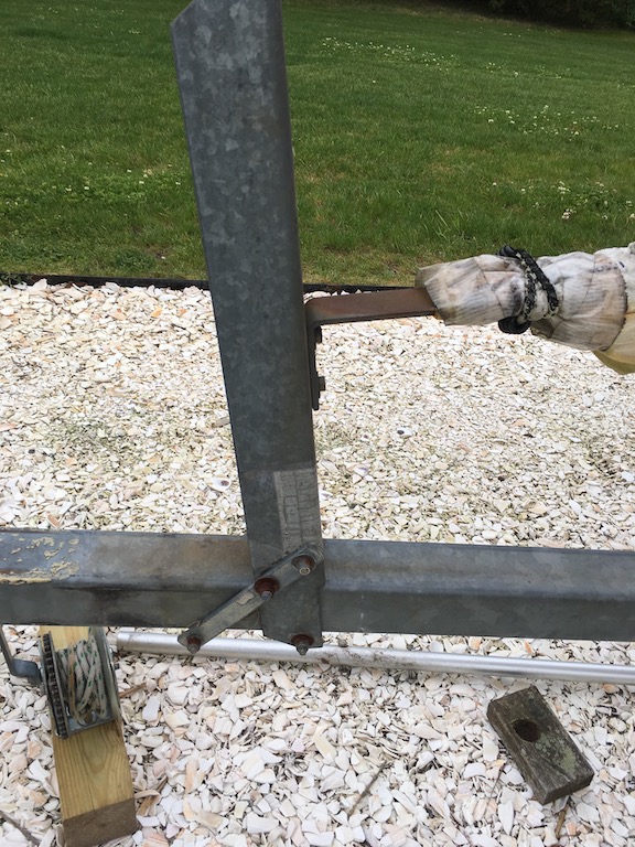

I spent some additional time with the trailer yesterday removing the winch from the winch post. It is very clear to me that my big issue at the moment is that the winch post is bent a couple of inches to starboard, so as the boat is winched up into the "make shift" bow stop the boat is pulled off center. Because of the wide V shape of the bow stop, manhandling the boat into a straight position is not possible without putting a lot of stress on the bow.
Hard to see in the pictures attached but the winch post is clearly the first item to tackle. Jalmeida51 thank you for the suggestion... "A good place to buy trailer parts is trailerpartsdepot.com I believe they are located in western Mass."
Off to a Harbor Freight store to buy some BIG wrenches to get the bolts and nuts off the winch stand. Everything is torqued very tight. I was thinking that before ordering a new winch stand, I may take a large hammer first and see if I can straighten out the post and the side brackets which are both clearly bent also.
A couple of pictures to try to show issue.

center line of bow pulled to starboard, resting on side of first roller.
Bow stop... trying to show that when boat is snubbed up to stop it is pulling boat off center of trailer
Side view of winch post / held on by bolts underneath post going across trailer. Post and the two side strips are all bent to starboard

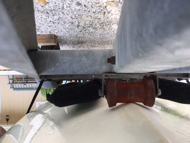

Postby RobH912 » Mon Jun 03, 2019 8:29 am
one other pictures (we're limited to 3 pictures per post?)...
picture of stern of the boat centerline on back roller... you can't see the center line as the stern is pulled off to port so that bow will fit into bow stop V

It's my belief, looking at your pictures, that I would be able to push the bow to center on my DS unaided. However, there's an easy way to get leverage here (literally). Stick a 2x4 under the front of the boat from the port side and push down on it. It will fulcrum around the nearest frame piece and will lift the bow (and helpfully provide a slope for it to slide to where you want it. At the bow, such point loads (applied briefly to the "keel") are no issue. You are not going to damage your boat.
(If needed, put a short bit of 2x4 on top of the frame to give you more precise control of the fulcrum. At some point, the slope is going to go the other way, so account for that).
Once the bow is straight, you can manhandle the back over by a few inches with main force. I prefer lifting the transom, but you can also wedge your back against a stern quarter trying to push up and over at the same time.
Aft of the Centerboard the V is not as strong, but if you carefully avoid putting a concentrated load in the middle of one of the flat hull sections, you can still support the hull temporarily on a narrowish support (e.g. to raise it off the trailer). Just make sure you support the V where the hull sides meet. (I would not work inside the boat if the rear rested on a single board, but it's fine to support the empty boat that way while you work on or under the hull, for example.

Postby GreenLake » Mon Jun 03, 2019 2:44 pm
You probably won't get anywhere with a hammer. Best bet might be to leave it on the trailer and stick a 4x4 or whatever size fits into the channel. Use that as lever to bend. However, I see that replacement winch posts start at $40 or so, which makes me think that just getting a new one is the best solution here.

I think that I made a lot of progress today on straightening out the winch post and the two supporting brackets that were also bent.
Used a 18" breaker bar with correct size socket plus a long handled box wrench and took the winch off, the supporting brackets off, the bow stop bracket, and then took the winch post off the trailer tongue.
Used a heavy hammer and an old piece of 4x4 wooden post and straightened out the two supporting brackets and the post (both were very bent). It was not difficult at all to hammer it out. Got the post and the brackets back on the trailer, but decided I'd finish in the morning on reattaching the bow stop bracket. Have not tried to straighten the boat out on the trailer yet, but I can eyeball the new post to the current position of the bow of boat and and it looks like it will be MUCH better when the bow is in the bow stop.

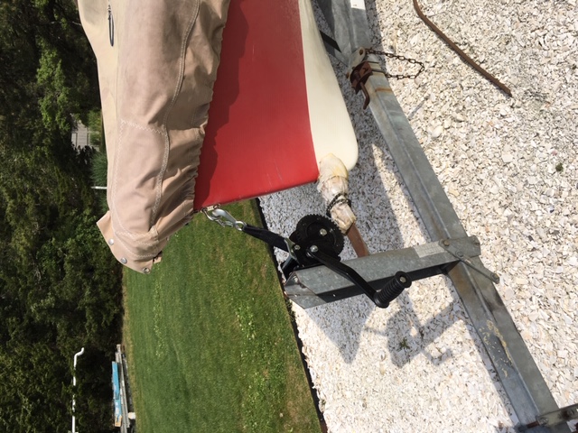

Postby RobH912 » Tue Jun 04, 2019 6:31 pm
Made some good progress today on the bent winch post.
Re assembled and installed the straighten post, attached the bow stop bracket, and it all looked much straighter to the trailer and to the boat. :D
The winch rope was frayed at the shackle, and when I spooled the rope out ran into an epoxy like glue clump holding the end of the rope into the winch... so at that point I decided just to install a new winch with a new strap. Seemed like a better idea and it was easy to install on the post.
Rather than try to use 2x4 to lift the boat and try to center it on the rollers, I just strapped the boat down to the trailer, went to the town landing, and let the water do the work. Got the boat to the center of the trailer, winch worked fine, but could see that some of the bunks are not touching the boat.

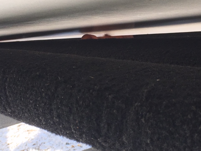

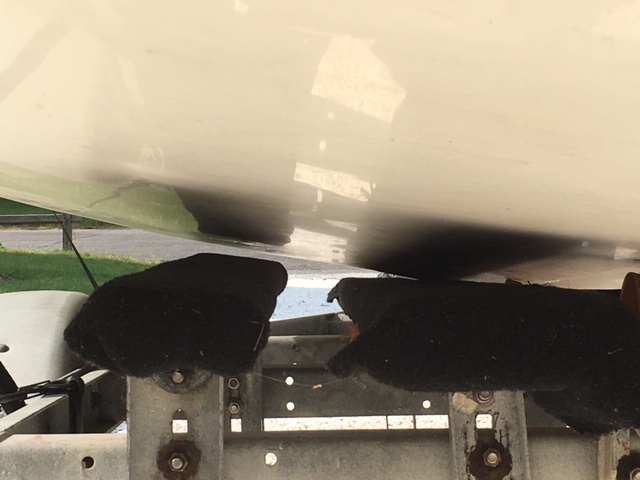

When I got home I could see that the boat was in straight/ lined up with the rollers, but could see that the boat wasn’t touching some of the bunks... at all !! Found this so hard to believe that I even got a wooden paint stir stick and slid it between bunk and boat. Wow
Spent several hours on Wednesday on my back adjusting the bunks.
A couple of pictures of bunks not touching hull, before I started working on it.

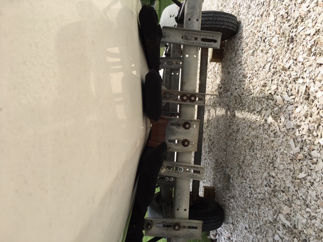

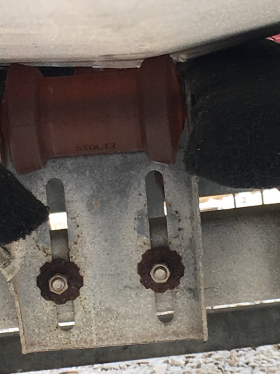

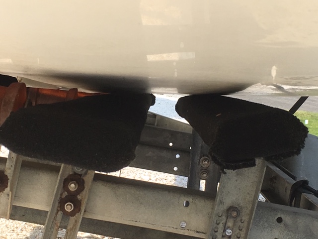

Here are some pictures after adjusting the bunks and showing that the boat now is straight to the rollers.
Now that I've gone around the boat once adjusting all 4 bunks I see that first one I did now needs to be readjusted to touch the hull. Need to get a torque wrench this morning to confirm that everything tight.

Also a picture of straightened winch post with new winch.
