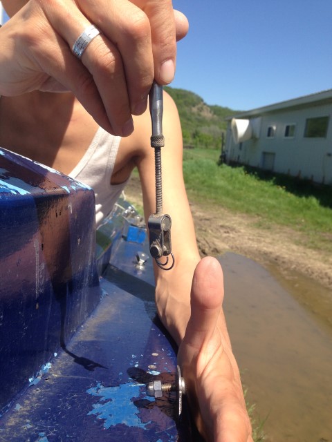

My wife and I raised the mast the other day and when we went to attach the stays found that the two side stays were too short (by 3-4 inches) even with the turnbuckles fully extended. I'm guessing it'd be okay if just took the stays off the mast and re-riveted them that much lower then all the tensions would still line up and I'd be good to go?

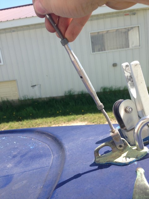

Also, although the front stay reaches fine, I may need to replace it because the bottom threaded part of the turnbuckle is bent and seems like it prevents the whole turnbuckle from tightening. Always 1 step forward 3 steps back :)

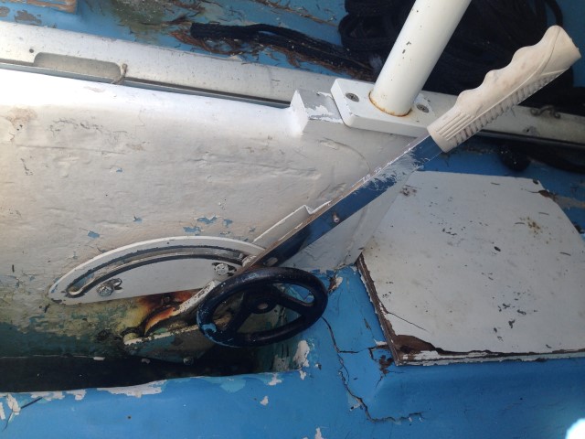

Also - the centerboard lever seems jammed. Don't know if it's because I'm still on the trailer but it barely moves at all. Daysailer manual says there is a lock pin but I don't see anything like that on mine. What's the lock pin look like?

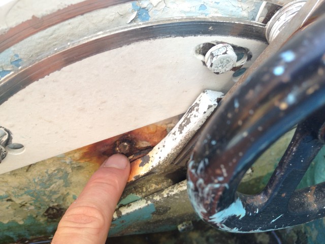

Maybe this rusty thing I'm pointing to is the lock pin?

Re: Centerboard lever
Postby GreenLake » Sun May 26, 2019 7:32 pm
That lever track looks like it is aftermarket. Even though your boat is a clone, and not a true DS, I've never seen this contraption and we've had some discussions of various DS clones.
If this was a DS, the locking pin would be on the bottom forward of the little triangle that's part of the original fitting. It's activated by gravity, if there, you should be able to feel it wiggle.
If boat on the trailer, the CB won't move much unless it happens to be unsupported from below.

Re: shrouds too short - something's OFF
Postby GreenLake » Sun May 26, 2019 7:47 pm
Something is off if these were shrouds that were original to the boat. (And if the forestay and shrouds are from the same set).
I would make sure that the mast support is not taller than it is supposed to be and that it is properly resting on the mast step at the keel. (And that the mast step isn't a "mast jack" that is dialed all the way up).
Now, if there's evidence that some previous owner had moved the mast tangs for the shrouds then restoring them to that position might be fine. (All three should attach at the same height)
However: the shrouds and forestay are normally calibrated to support the mast a certain angle (the mast rake). If you change your mast rake the sailing characteristics of your boat will change - probably for the worse!
When the boat is level on the water (and empty), the mast should point ever so slightly aft. From memory, I believe if you tie a weight to the end of the main halyard, it should come down about a foot aft of the mast at deck level (that should translate to 3°). Don't quite remember the exact value, but minimum would be one hand width (3" for 1°). You cannot try this on the trailer, at least not without leveling the boat to where the waterline is level.
Or you can measure from mast tip to transom.
The mast rake should be 25+- an inch from the top of mast to the transom.
You can then also check that the mast tip is centered laterally by making sure the distance from the aft corners to the mast tip is the same for starboard and port.
The 25' figure works only if you have a mast of the proper overall length, of course.
You need to really investigate this before doing the "random riveter".

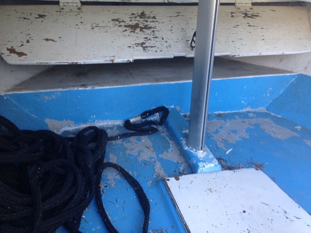

Also took a picture of where the mast sits as you mentioned you couldn't figure out how that was set up.
Here's the mast sitting on the footing.

Postby GreenLake » Thu Jun 06, 2019 4:07 am
So you have DS clone as a boat, but with a mast (and presumably stays?) from an actual DS.
Nobody here really knows your boat, so it is possible that the hull of your boat is shallower, so that chain plates are further from the tip of the mast, but it seems more likely that the mast is simply a bit too long. Let's see what we can figure out from your new measurements and picture.
If you look at your picture, it shows a small platform for the mast step, surrounded by a wider platform (flat blue). There seems to be an access panel (white) indicating that there may be considerable distance between the platform and the actual hull.
I would have expectd the mast to be too high above the deck because of that, but your mast-tip to partners measurement is within 2-3" of expected (the standard measurements, other than that for the mast rake, are all based on the top of the sail track, not the actual tip of the mast).

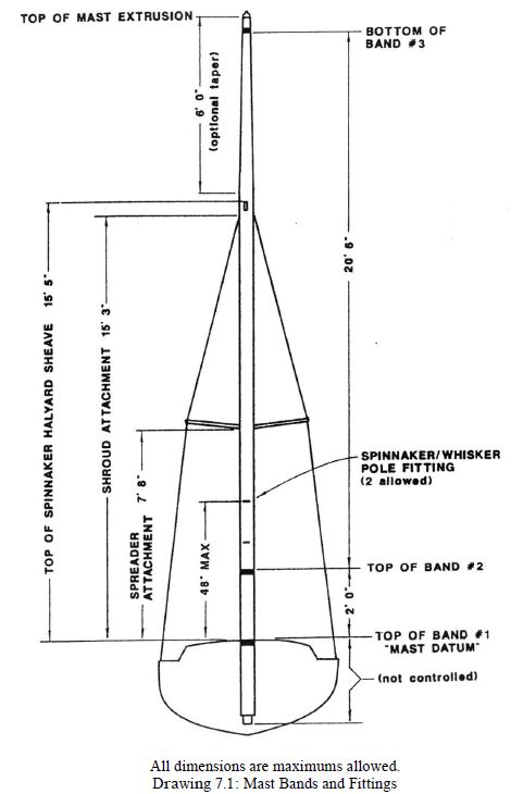

I'm attaching a drawing from the DS Handbook of a few years ago. This gives various lengths in reference to the deck level.
(The "band 3" in that figure is how high you can possibly raise your sail, so it's practically at the end of the mast track, if you want to relate it to my measurements. Band 2 is at the top of the boom, and my 16-18" "clearance" agree with that, if you add the width of boom itself: to get to the 24" in the diagram).
You should also be able to confirm whether your shrouds are attached to the mast at the expected position (22' 6" minus 15' 3" equal 7' 3" from the end of the mast track). Likewise the spreader brackets (15' 3" minus 7' 8" equal 7' 7").
If they are off by 13", either the deck layout of your boat is really different (that is 13" taller from the chainplates - which I don't believe based on the pictures) or your shroud attachments were moved. Based on the diagram, you should confirm their location.
If they are attached in the right place, but still come out short, you could have super wide spreaders. From what I remember that was not the case. Or they are mounted too high, so that the upper part has a steeper angle. Still 13" would be a huge discrepancy.
In summary, what you are trying to do is match the configuration above the deck level as per the diagram. If you are able to match that, then you can use standard DS sails and you will have enough clearance for a boom vang.
Looks like your mast is approx the right length relative to the deck level, which is good and after you have confirmed you shroud positions you should be able to figure out whether they need to be moved or are just too short for some reason.
Hope this all makes sense if you apply it to your boat.

No, but you can see that 15' 4" can't be correct. The attachment points are 15' 3" above deck level, and you lose some because of going around the spreaders. So with 15' 4" your stays should be hanging slightly above deck level. However, your chainplates are clearly below deck level.
At this point, you do need new stays, and the best course for you is to call Rudy at DR Marine to order a new set. You can confirm with him that his are longer than 15' 4". You should let him know that you confirmed that the attachment point is at the correct height above the deck and also let him know of your 15' 13" straight-line measurement; then let him confirm that he can deliver the correct stays for you.
