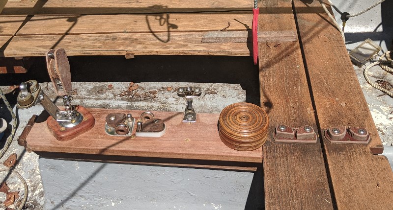

From the rear (left side) to front, I've got a cleat for the spinnaker halyard, the mainsheet swivel cam/jammer, cleats for the spinnaker sheets/guylines (depending on which tack), a tube-swivel cleat for the vang line, a tactical compass, and cleats for my jib sheets on the thwart. I'll admit that it's a lot and may be too cluttered, but I think it will work for ME. Keep in mind that I'm not racing and I'm usually sailing solo, so I wanted everything close at hand for where I usually sit, about 18" back from the cuddy. I'll also admit that there's no good reason for the tactical compass except that I saw it in an antique shop in that nice walnut box and just couldn't resist. It's got a cover for when I'm not using it (and I put a mayonnaise jar over the whole thing for when it's on the trailer):
- CB Cap, compass covered
- ResizerImage640X343.jpg (143.83 KiB) Viewed 14986 times
Anyway, all the hardware is screwed and glued to a 3/4" plank which is itself screwed and glued to two "side rails'" which are then thru bolted to the top of the centerboard case. The bolt-holes are about an inch from the top of the case, don't interfere with the CB at all, but I'll have to put some caulk at each of the holes to avoid weeping (right now, the cap is just test-fit onto the case). Most of the time, I'll be sailing with main- and jib-sheets either in hand or cleated down (depending on wind speed/steadiness) and grabbing the vang-line as needed. So not too cluttered, I hope. On the other hand, with everything set, you wind up with this:

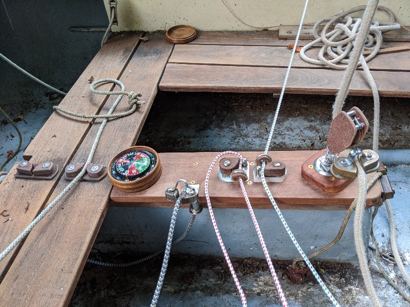

- Testing the lines
- ResizerImage640X480.jpg (201.79 KiB) Viewed 14986 times
Which I admit is a bit much - from left to right it's jibsheet, compass, vang, port spinnaker sheet, star spinnaker sheet, mainsheet, spin halyard. But remember, when the spinnaker is set, the jib will be down, the vang will be pretty much full on and then not touched, ditto the spin halyard. I'll only be playing the spin sheets and the main, so hopefully will be manageable. I've also set up my turning blocks for the spinnaker sheets, which I'll show in the next post....
